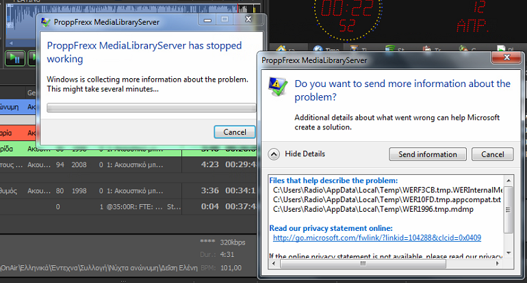

MLS and PF are running on the same (onair) pc.
I 've let PF running for a few hours. Then it stopped playing new tracks.
I went to studio and I saw that MLS had crashed :
Screenshot 2014-04-12 00.22.46 (1).png (217.9 KiB) Viewed 10788 times
Any idea why this happened ?

Yes, I am just to provide/build a new version!
The error happened, as an access log file could not be closed - which is rather strange as well, as this also a simple system IO function I am calling, which according to Microsoft can never fail...but as we saw it - it failed. So I wrapped into an extra try-catch block, so that this would crash any running MLS, meaning I simply can only ignore such an error!
The access log files are btw written to the MLS AppUserData folder, e.g. "C:\Users\yourname\AppData\Roaming\radio42\ProppFrexx MediaLibraryServer\3.0\log".

Re: MLS crashed
No, but to get an idea on what wad causing it, please send me the files as listed in the dialog we see in your screen shot.
These files can be used to get an idea bout the crash....

Re: MLS crashed
Post by hdradio »
Unfortunately those files do not exist anymore in that directory.
They might have been deleted after Send Report Dialog.
Re: MLS crashed
They should still (maybe) available from within the Windows Event Log.
The error however didn't directly originate in the Media Library Server (MLS) itself, but in an OS related function (which has been called by the MLS).
So it is rather important to see why this happened. As the MLS itself doesn't process any audio, but just reads the files from the I/O sub-system as well as communicates with ProppFrexx ONAIR via the network, I can only guess, that the error must either due to a fault on the I/O (e.g. a defect file or hard disk error) or an error in the network.

Re: MLS crashed
Post by hdradio »
I have sent you the event log.
Did you have a look at it ?
Re: MLS crashed
The additional check as mentioned above is now available in v3.0.13.14 - make sure to fully terminate your running MLS when upgrading...
