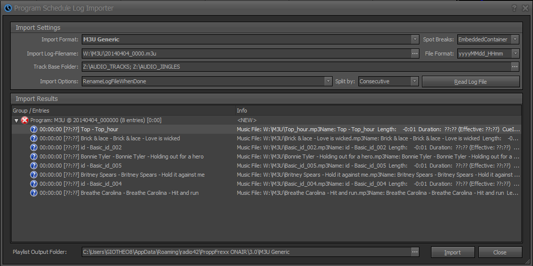

I try to use the scheduler import module to import a m3u files within the proppfrexx program scheduler.
My m3u files contains :
Top_hour.mp3
Brick & lace - Love is wicked.mp3
Basic_id_002.mp3
Bonnie Tyler - Holding out for a hero.mp3
Basic_id_005.mp3
Britney Spears - Hold it against me.mp3
Basic_id_004.mp3
Breathe Carolina - Hit and run.mp3
And here are the settings for importing :
All the audio files are well included into the folder Z:\AUDIO_TRACKS and Z:\AUDIO_JINGLES.
However, import seems to not being able to find the audio file. The red cross seems to tell "it's not okay", isn't it ? What does the question mark mean ? And finally, I see "Music File : W:\M3U\<file_name>.mp3....." but this is the m3u file folder (audio files are not into this folder). Not the ones that I tell ProppFrexx to search into...
What is wrong in my settings ?

Re: Scheduler import module : M3U
An m3u playlist file is currently a little exception, as it is assumed, that the file location given in the m3u file is already correct.
This is because of the definition of an m3u playlist file format. Entries must either be in absolute notation or are defined to be relative to the location of the m3u file itself.
As such, the content of your given m3u file is not correct according to the m3u specs.
As such I so far do not try all alternative given locations (as specified in the base folders).
But I agree, that this might get optimized in the next version for the m3u import, as such, if the base folder check might get added here as well.
As I just released a new v3.0.13.12 - this enhancement made its way - so now the 'Generic M3U' importer also considers the base folders...
