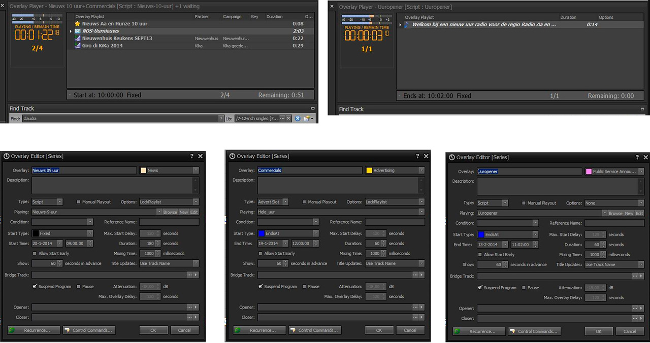

Bernd,
We have 3 overlays: news (with option lockplaylist), commercials (with option lockplaylist) and a welcome jingle without option lockplaylist).
Now in the overlay playlist only news and commercials are visible and you can see 1 is waiting. The one waiting is that welcome jingle overlay.
How can I combine all 3 overlays in the playlist without the 1 that is waiting? So our users can see all 3 overlays in the playlist.
Regards,
Bert
Regards,
Bert

It's correctly played but not 100% visible.
First the user will see the overlay playlist with the news and commercials and second the welcome overlay which is playing the jingle.
You can see all settings in the picture I made.
Bert
Bert
- Our settings
- Overlays_ProppFrexx.jpg (197.45 KiB) Viewed 10408 times

Looking at your screenshots I assume you picked some unrelated entries, as they start at 09:00:00, 12:00:00 and 11:02:00 and even at different dates...- but I assume (as they might have different recurrence settings) you mean the following:
1: Commercials - EndsAt @ 10:00:00 (starting 60 sec. in advance)
2: News - Fixed @ 10:00:00 (starting 60 sec. in advance)
3: Opener - EndsAt @ 10:02:00 (starting 60 sec. in advance)
Note the 'Show in Advance' settings:
Defines the time in seconds the overlay is shown in advance of the actual start time (e.g. giving the user time to cancel, delay or edit the overlay).
When using the 'EndsAt' start type you MUST set this value high enough, i.e. it should reflect the maximum duration of all items played by this overlay.
In your case the 'Commercials' can not be longer than 60 sec.!
Anyhow, in your Situation not all the above conditions seem to match!
While your first two entries (the News and the Commercials) do start at the same time, they can be combined - but the 3rd Opener entry effectively starts while the Overlay-Player is already running/playing the first entries - as such it can not be combined !!!
In addition the 3rd entry is set to the 'EndsAt' start type - which doesn't make much sense to my mind...as I guess it should be played right after the News/Commercials?
So in order to start all your 3 overlays at almost the same type, you might define them as given here:
1: Commercials - EndsAt @ 10:00:00 (starting 91 sec. in advance) -> effectively starting at 09:58:29!
2: News - Fixed @ 10:00:00 (starting 90 sec. in advance) -> effectively starting at 09:58:30!
3: Opener - Fixed @ 10:00:01 (starting 90 sec. in advance) -> effectively starting at 09:58:31!
Now all 3 overlays will effectively almost start at the same time (note, that the exact effective time also determines the order in which they are played).
As your commercials might be longer - you can adjust (e.g. increase) the show in advance time from 90 to e.g. 120 sec...as needed.

Problem solved!
Your example work!
Your example work!
