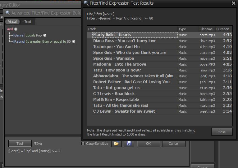

Is it possible when using the expression builder to display the number of songs found?

d) Is it possible when using the expression builder to display the number of songs found?
When using it from within the Script-Editor (eg. with the 'Random' action) you will find a 'Test' button in the dialog...
Else go to the 'Find Window', select the resp. media library you want to specifically test (or leave it to <All>) and the perform the search...the result window will tell you all you need, including the total number of tracks found in its status bar.

Also can the Test button exist in Advanced Filter/Find Expression Builder ?
(But I see also that in Filter/Find Expression Test Results there is not any number of found tracks. Just the list of the titles found).

Find window. It displays the found tracks but not the number of tracks.
As already said, take a look to the status bar of the Find Window!
It will display something like "X found in LibName [TotalCount]"

Also in Filter/Find Expression Test Results there is nowhere a indication of number of files found. See screenshot:
Which dialog are you referring to? The 'Find Expression Builder' exists at the following places:
1) Find Window
2) Script-Editor - Filter column
3) Script-Rules - Previous/Next Track Conditions
The 'Find Expression Builder' can of course only display the number of 'matching' tracks, if tested against a given/known media library.
This is e.g. not the case for 3) - that is why the 'Test' button is missing here!
The 'Test' button in the other cases also only returns up to the first 200 matching entries found - to limit the testing.
E.g. if you are using a very complex expression rule, this means all tracks of a media library would have to be tested...this might take significant time in case you are using a large media lib (e.g. containing thousands of tracks)...as such the full number is only shown within the 'Find Window'...so to fully test some filter expressions, you might use this feature.
Correct and I already told you so in my posts above.
That's why you asked where to find that number in the Find Window...which I answered.
