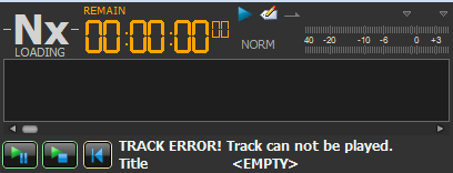

Strange thing happening (don't know if it happened in earlier versions, but in the most current it happens to me once in a while)
- Use VT module (standard way, nothing special. No att volume etc)
- At the end, use Reset All to cancel and start all over again
When doing that, it ends up with the NX player showing a 'Track error' message, see screen dump
NX Player VT error.jpg (55.21 KiB) Viewed 8452 times
I've tried reinstalling, using other playlists, using other audio files, but error keeps coming back...
Any idea ?

that is indeed strange and sounds like a random issue - so it is not happening with the same tracks every time, but once in a while?
I just tried to reproduce that here with a pretty huge playlist and pressing the 'Reset All' button a couple of times per track...but was not able to reproduce it yet.
What driver model are you using (WDM, WASAPI, ASIO)?

Strange isn't it ? Still can't figure out if there is a logical order which triggers it. In my idea it shouldn't be the sound card, as it is working 95% of the time, but fails the other 5%. I'm using WDM (Virtual setup on my mac using Parallels).
Try to catch it for you on screen grab (video), if that works out, I'll send you the file.

Yes, that sounds funny and I also guess it will not be related to the soundcard - as it is not involved when creating a decoding stream.
It more sounds like an I/O issue.
Do you know, if it might be the case, that it is happening only for particular file types, e.g. only with MP3s or only with FLAC etc.?

Please also try the latest v3.0.11.47 - I have tried to tweak the I/O a little here - so maybe that already did the trick for you.
