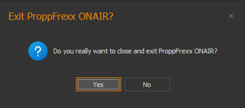

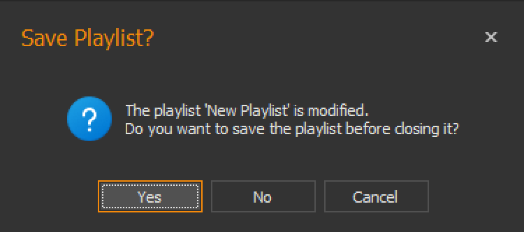

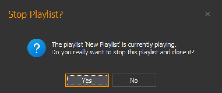

But note, that when you close ProppFrexx but also currently play a playlist window, that you might get 3 dialogs, which you all have to confirm resp. answer correctly.
1. Dialog: Confirm, that you want to close ProppFrexx - YES

2. Dialog: Confirm, that you want to stop the currectly playling playlist - YES

3. Dialog: Confirm, that you want to save the playlist - YES or NO
Screenshot 2025-10-30 160659.png (11.25 KiB) Viewed 30450 times
If you cancel any of the above dialogs, ProppFrexx won't exist.
This happen to me, no matter, if I dock or undock any window panels. I.e. even, if I undock the mixer panel and the Find panel to another secondary monitor and confirm the above dialogs (e.g. YES, YES, NO) ProppFrexx would close gracefully.
So it is strange, why this is not the case on your end - are there are error messages or a like?
