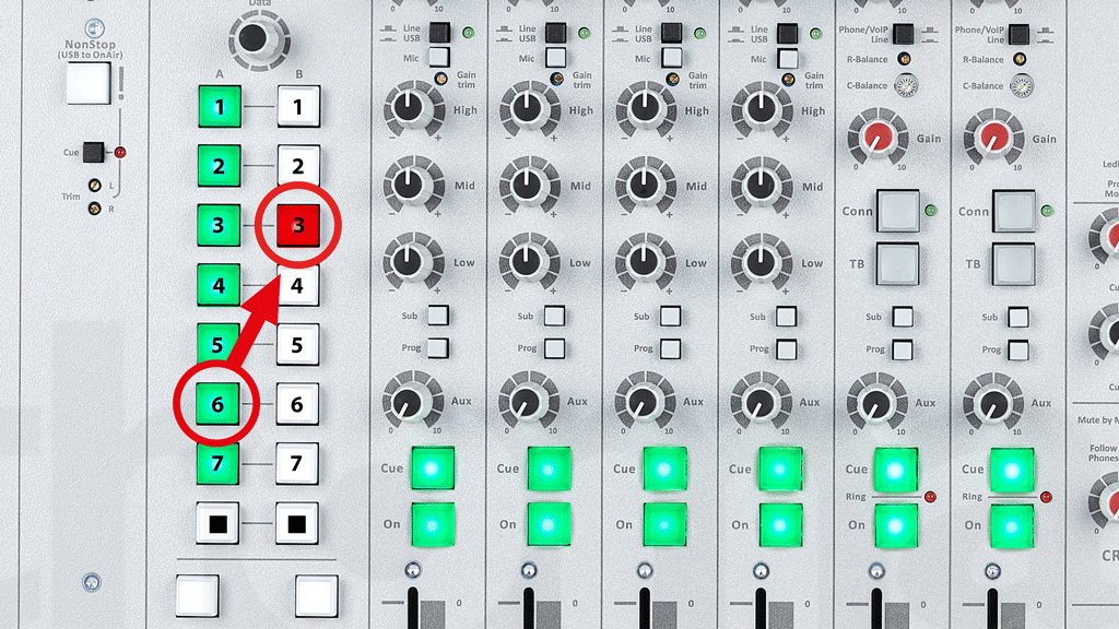

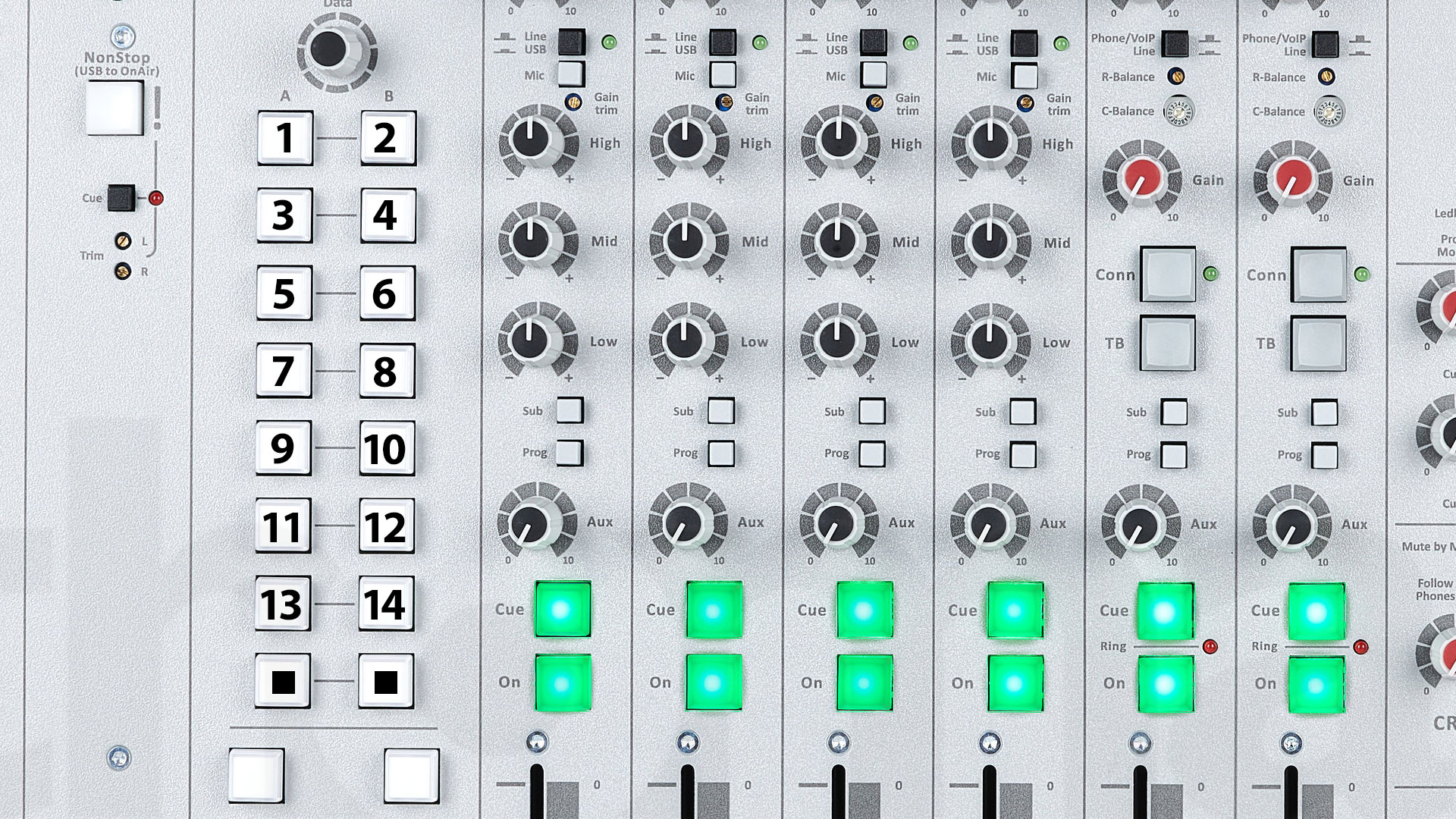

I am trying to figure out how use the Events/Commands in the General Settings to let ProppFrexx ONAIR recognize by itself how much jingles there are in the Cartwall when it is loaded, and accordingly light up the necessary buttons from the Control Module on the D&R Airence MK2.
For example; there are 4 jingles in Cart 1, and 7 jingles in Cart 2. Is it possible that ProppFrexx recognizes this, and only lights up the first four buttons (1,3,5,7) with a green color from column A, and seven buttons (2,4,6,8,10,12,14) with a green color from column B instead of all, none or set them up manually every time what is a kind of hassle?
When a Cartwall is loaded with a another jingle library (for other type of show) that has more, less or no jingles the Airence has to accommodate to this and has to put more or less lights on or out.
When a jingle is started, only that light should flash in red and not all the lights. Has the jingle done playing it should go back to green.
Playing the jingles is set in the GPIO-Client, and this is functioning like it should. It’s only the visual representation on the Airence that I’m stuck on.
Is such a thing possible in ProppFrexx ONAIR?
Many thanks in advanced!

You can first (when you load or change your cartwall, see the I:/II: OnCartwallChanged event in the general settings) turn off all LEDs (see e.g. EXEC_SEND_DRAIRENCE_SETLED 255|0).
And then you execute for each button (1..24) a conditional command (EXEC_COMMAND2). The condition is, if the trackname is not empty (e.g. a track is present) you set the LED to green (2) - else you do nothing, so it stays off.
Example (I: OnCartwallChanged):
ASYNC
EXEC_COMMAND2 ${cw1cart1trackname}|NOT(Equals())|EXEC_SEND_DRAIRENCE_SETLED 1|2
EXEC_COMMAND2 ${cw1cart2trackname}|NOT(Equals())|EXEC_SEND_DRAIRENCE_SETLED 2|2
EXEC_COMMAND2 ${cw1cart3trackname}|NOT(Equals())|EXEC_SEND_DRAIRENCE_SETLED 3|2
EXEC_COMMAND2 ${cw1cart17trackname}|NOT(Equals())|EXEC_SEND_DRAIRENCE_SETLED 17|2
EXEC_COMMAND2 ${cw1cart24trackname}|NOT(Equals())|EXEC_SEND_DRAIRENCE_SETLED 24|2
You can use the OnCartPlay resp. the OnCartPause event to let the LED BLINK resp. stop the blinking. This should also already be used in the D&R template, see here: https://github.com/benhartwich/proppfrexx-remote/
Example (I: OnCartPlay):
EXEC_SEND_DRAIRLITE_SETLEDBLINK ${cartid}|1|3|1
Example (I: OnCartPause):
EXEC_SEND_DRAIRLITE_SETLED ${cartid}|2

I successfully have setup the loading of the first Cartwall on the Airence with the codes you’ve provided. :D Thanks again! And after some tweaking I have two vertical carts on the Airence as they are numbered differently then on an Airlite. My cart 1 (A on the Airence) is: 1, 3, 5, 7, 9, 11, 13 and 15 is set as fade out cart 1. Cart 2 (B on the Airence) is: 2, 4, 6, 8, 10, 12, 14 and fade out cart 2.
The "OnCartPlay" and "OnCartPause" work partly too. When I for example load a cart library with 7 jingles into cart 1 or cart A, all 7 lights light up perfectly underneath each other, and when I then activate jingle number 6, the correct jingle plays, but light 3 from cart 2 or cart B starts blinking red. When it ends it turns green. A4 lights up B2 and so on.
How can I set this up, the way the knobs of the Airence are setup?

You have to transform the horizontal to vertical numbers.
See these posts and following:
viewtopic.php?p=13356#p13356
Ie. you might want to use the *[TOINT:{${cartid}}:{vert}:… macro as explained in the above posts…

After some trial and error I managed to get it to work for Cartwall 1. :D
Now I duplicated these settings for Cartwall 2, but this isn’t working correctly, because just copying these setting isn't probably the correct way to do this I guess. The buttons of the second vertical row on the Airence play the correct jingle, but it lights up the lights from the first vertical row instead of the second one. What am I doing wrong?
Also when I load a jingle library containing 4 jingles into Cartwall 1, the correct 4 buttons from the first vertical row on the Airence light up. But when I then at the same time load another Jingle library into Cartwall 2, the lights from the first vertical row go out, and the second row lights up correctly with 7 lights. Do you have any idea how this can be solved?
Thanks again for your valuable time!
Posts: 9029
Re: Setup Cartwall Lights on Control Module of D&R Airence MK2
Isn’t that logical? You want to use the 2nd row for the 2nd cardwall. And the 2nd row has different numbers on the mixer. Ie. you need to adjust your calculation and simply add a number to the cart id.
I guess you can do the math yourself. Note, that I don’t own a D&R mixer. So I don’t know the exact button numbers, but I guess a user has already listed the numbers in the above posted links…

The solution was found in the user manual. I just had to add a number 2 to the {vert} command, like {vert2}. :)
But it still doesn’t work the way I would like it to work. So, now a new challenge is already facing me. :?
Right now it is possible to load for example a jingle library with 3 jingles in Cart 1 with the related buttons lighting up on the Airence. When I then load a 7 jingle library into Cart 2, the correct buttons (second row on the Airence) light up on the mixer, but the first row with those 3 previous loaded jingles go out. So, right now I can’t have them both light up correctly.
I have OnCartWallChanged set to:
Followed with:
and so on for the other buttons.
When I remove the first line (EXEC_SEND_DRAIRENCE_SETLED 255|0) because it puts out all lights, it works like I would like to have it. But, when I then load one of the two Cartwalls with another jingle library, the lights are not changing accordingly to the new loaded Cartwall.
Can you please guide me to were and what, I have to add or change in some commands?
Thanks again! :D
