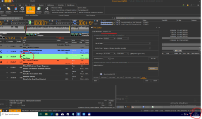

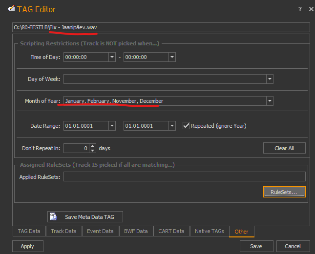

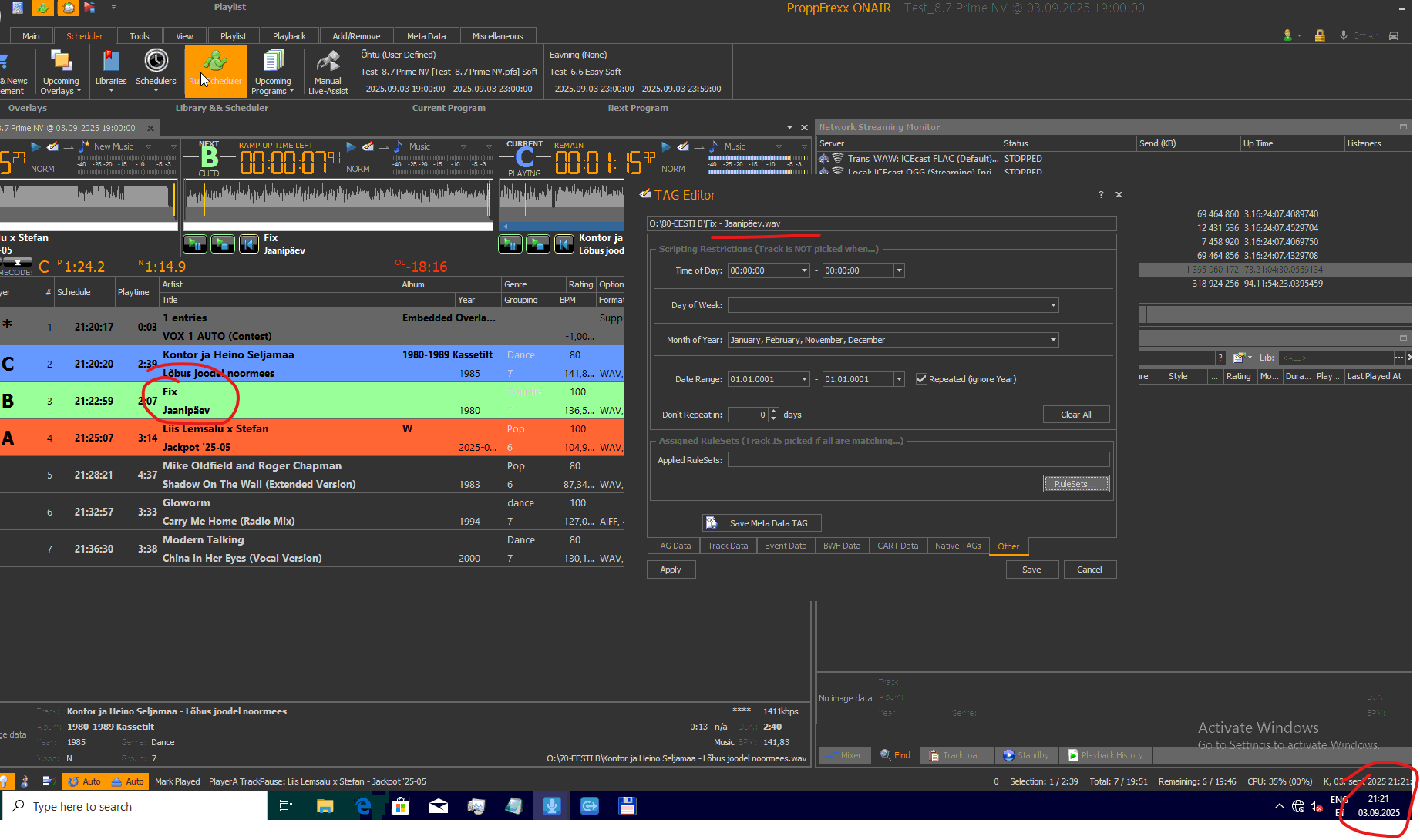

Hi
I mark one song do not play this period
but the computer still plays it??
Re: Why play song wrong time
How do you schedule the tracks, via a script-line?
Is the entry really the same file? And have you reloaded the media library (ie. have you changed the restriction from the media library entry)?
And are you using the Professional or Enterprise License (Premium or Basis doesn’t support script restrictions)?
