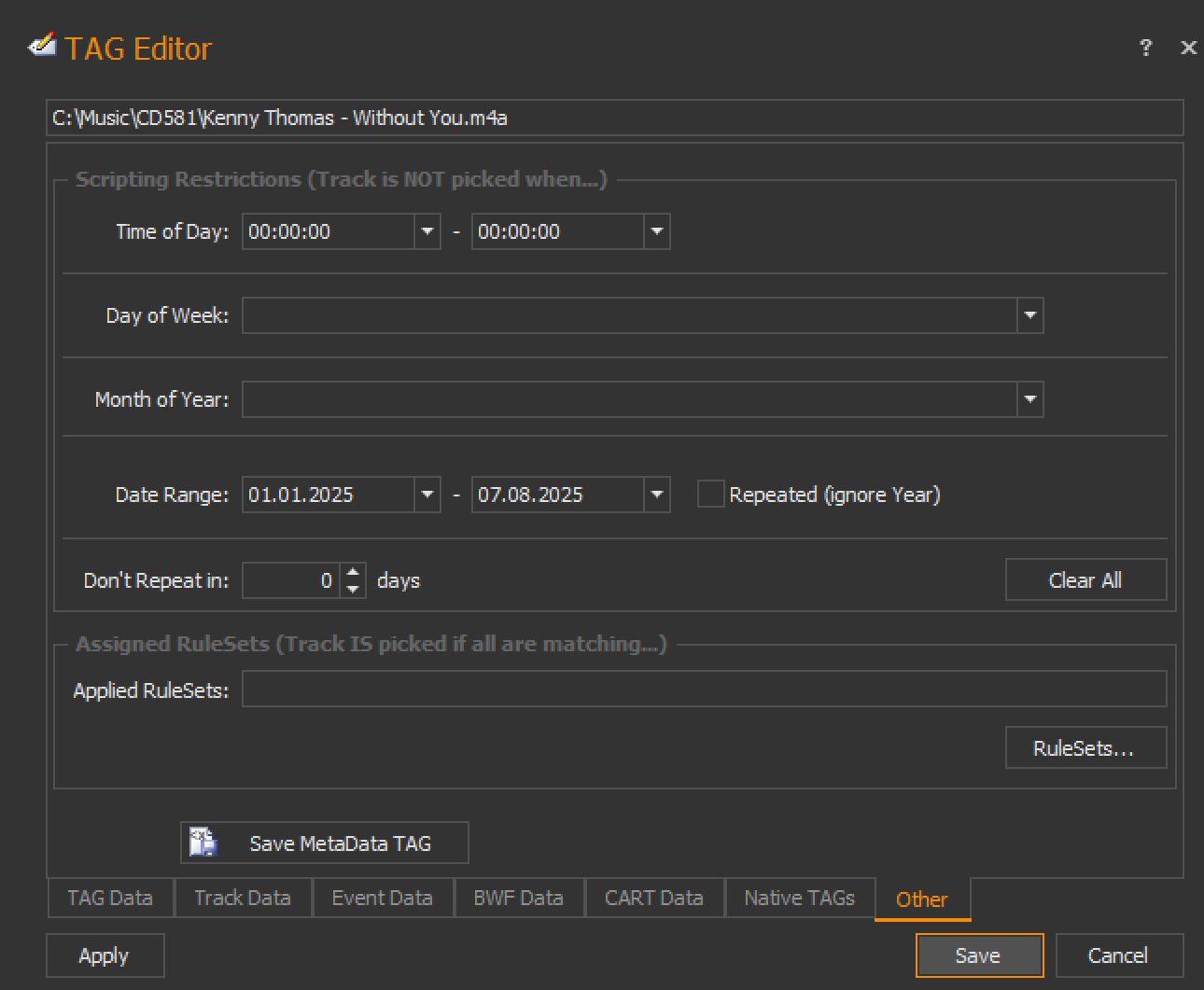

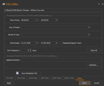

Here is a real life example: The given track should not be played before the 8th of August 2025:
Note, that I added the restriction under Track is NOT picked when... the Date Range is between an early date and the 7th of August 2025. After it can be picked.
