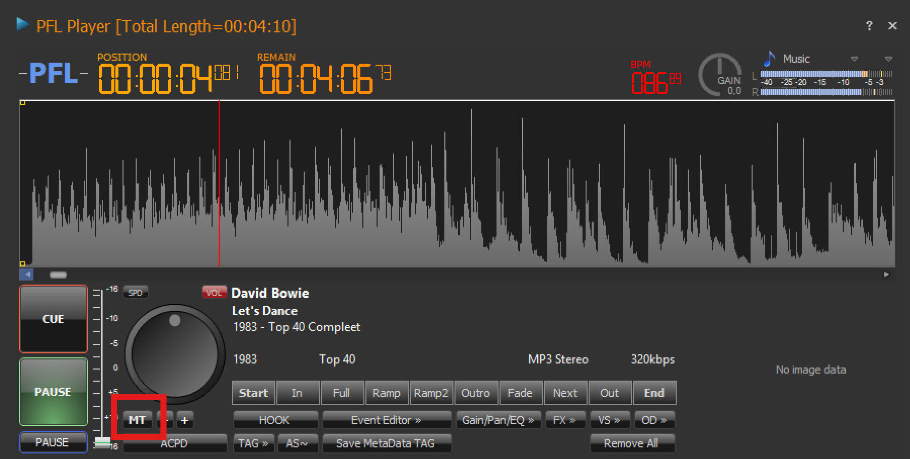

Thanks for the video. You are testing with the PFL Player, but the default settings I told you only apply to the DJ Players!
Try in the DJ Players :-)
In the PFL Player you would have to manually switch between normal CD mode (CD) and the Master Tempo mode (MT) using this button:
So you can even during playback change the tempo slider and toggle the mode between CD and MT mode to hear the difference.
I have send you a video to hear the difference.
Note, that the PFL Player maintains the last selected mode CD/MT. While only the DJ Players are set to the selected mode when they are created, i.e. when a new playlist window is created.
