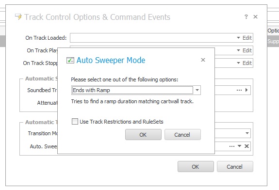

And can you prevent your jingle from playing on the intro of the music? The Jingle may not play like a Sweeper.
Thanks for the help.
Would it be possible to select here not to play the intro or ramp? Or is there another way please?
Re: Play the same media type in cartwall and music libary
Yes and No, that is the only option.
But, as said, you can click on the small arrow to further set additional Auto. Sweeper options. E.g. the "AlbumArtist Match (VO: Protect Ramp)" option.
Any 'VO' option will keep the 'Sweeper' as an extra track in the playlist.

It worked! Beautiful, thank you in advance!
