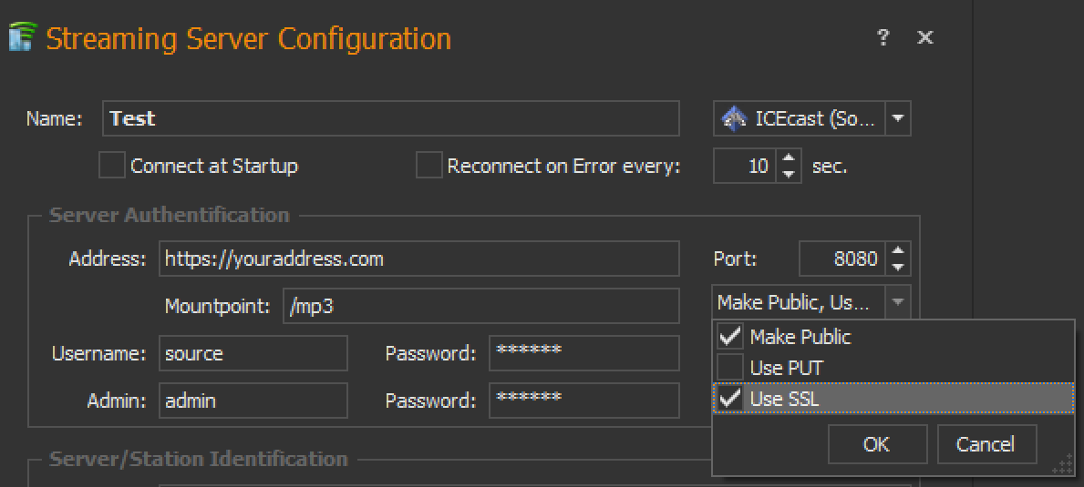

Hi there,
I am looking how I can use https://my-icecast.tld/mountpoint to stream to. How can I achieve this? I found this topic, however without a reply unfotunately; viewtopic.php?p=15232&hilit=icecast+ssl#p15232
I tried with port 443 but no luck so far..

Beside using https, you must also specify the ‚Use SSL‘ option (see the combo box below the port number). This option must also be set. That’s all you need to do - beside the proper config on the ICEcast server side.
Seems, that I must have overlooked that old post. Sorry.
