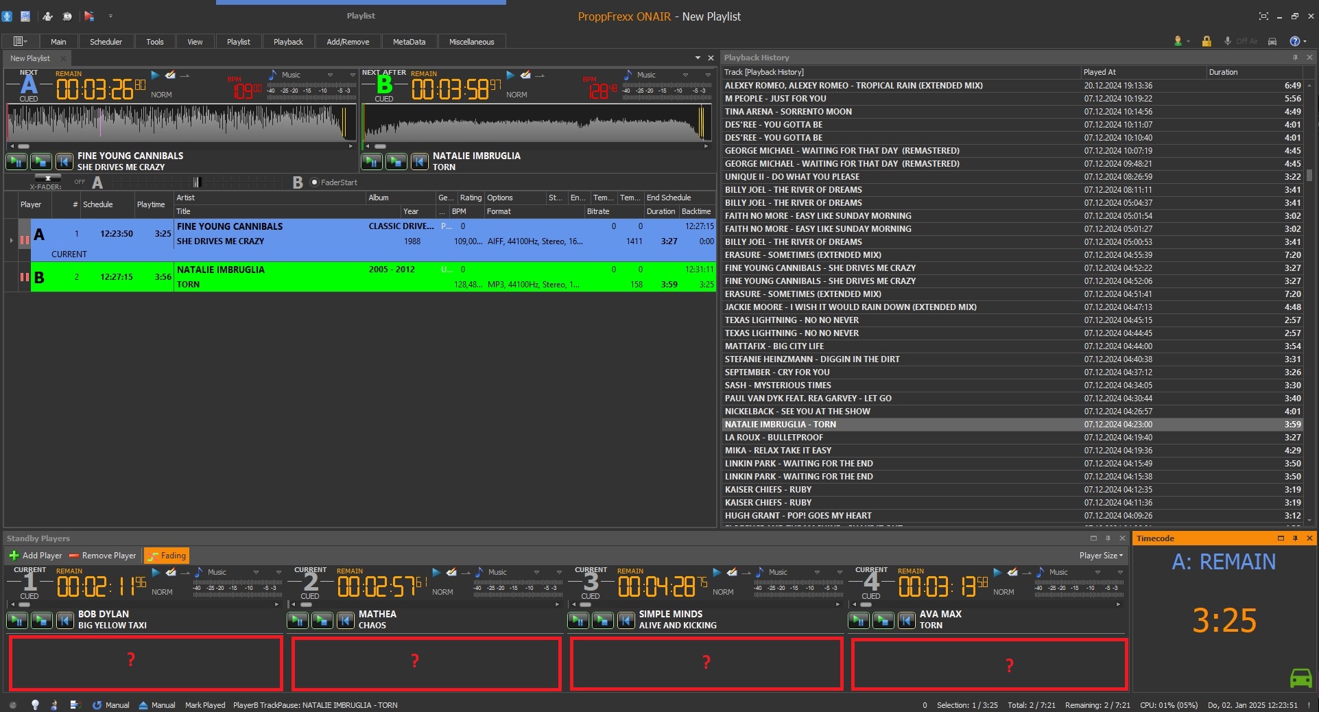

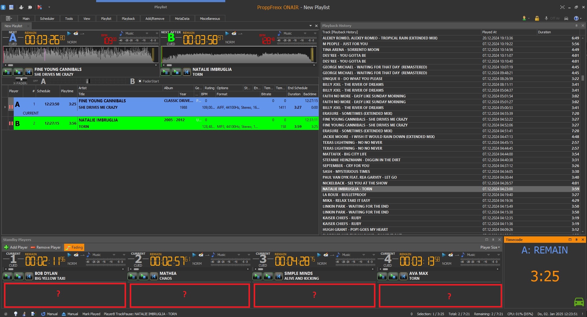

I have a question. By chance I saw that you can display or fill playlists under the standby players.
After two hours I still haven't figured out how to display it.
Could someone please help me here, it's probably a very simple thing but I can't find it.
Here is a view I found in the forum, the way I would like to have it but unfortunately I can't find it.
Thanks Tom

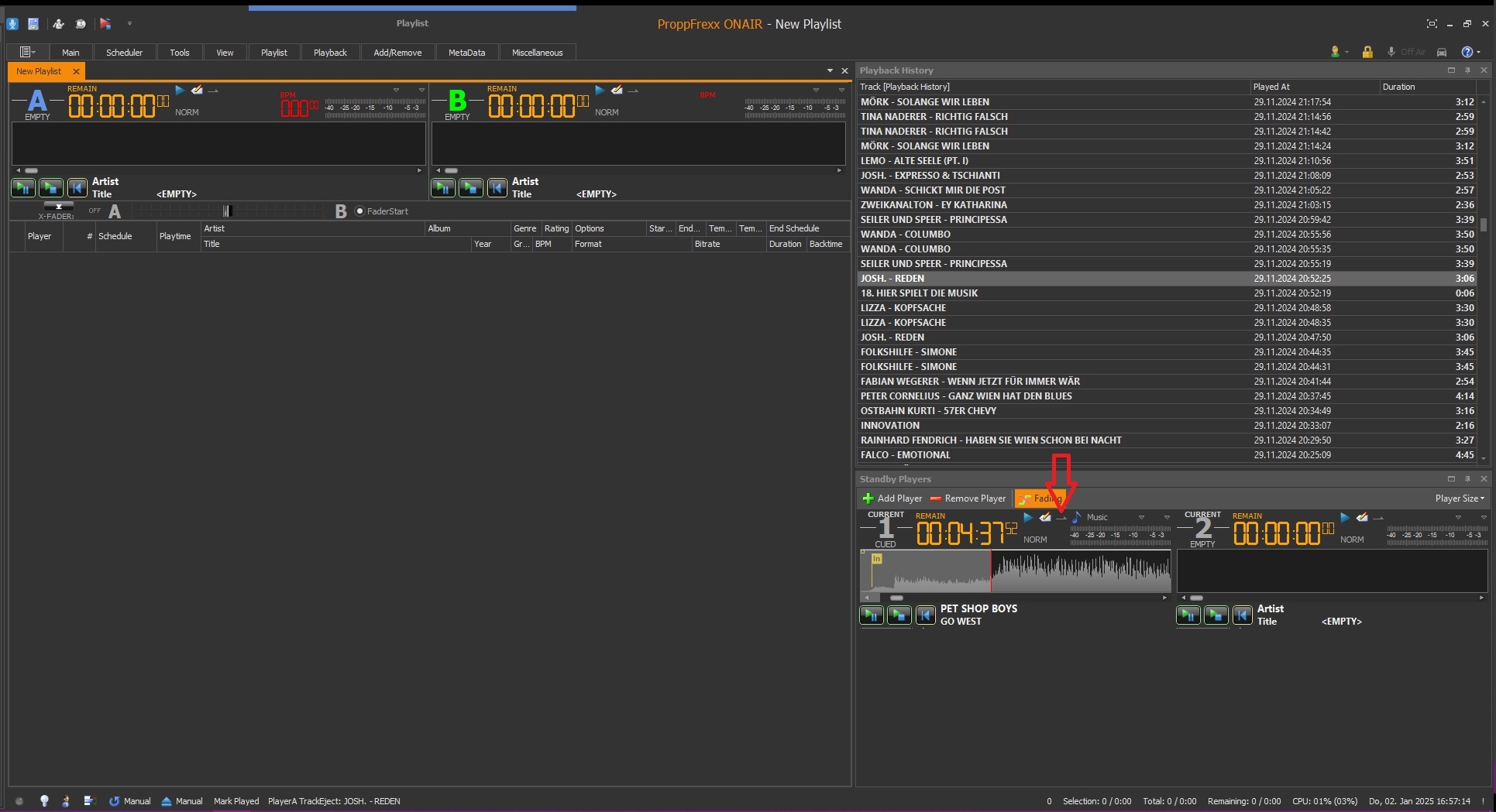

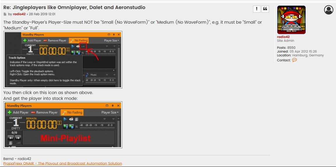

I landed on a page in the forum where this is explained. Unfortunately the stacked mode doesn't work, so you can't even switch between them. According to the instructions, it has to be SMALL, MEDIUM, FULL for it to work. There is a symbol, but it only controls how the player plays, not for switching to mini playlist mode.
viewtopic.php?p=11457&hilit=trackboard#p11457
Resetting the GUI (layout) didn't work either.
It could be that something went wrong here.
The players are set to horizontal, not vertical, but it doesn't make a difference.
So if any of you have an idea how to switch it, I'd be very happy.
Thanks Tom

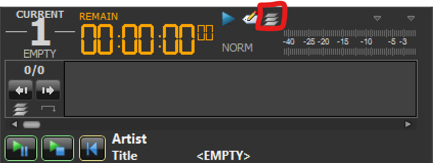

I found the error, there must not be a song in the player!!!! then the switching works.
Only by chance did I look at the picture again and it said, When Empty click here to Stack Mode!!

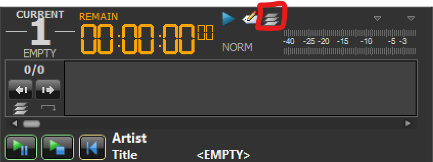

The Standby-Players can be put into a 'Single Track' mode or into a 'Stack' mode. Use the small icon in the top middle next to the PFL/Tag icon to toggle the mode.
In 'Single' mode you can only add (and play) single individual tracks to the Standby-Player.
In 'Stack' mode you can also load playlists or add multiple tracks to the stack - which is basically a mini playlist.

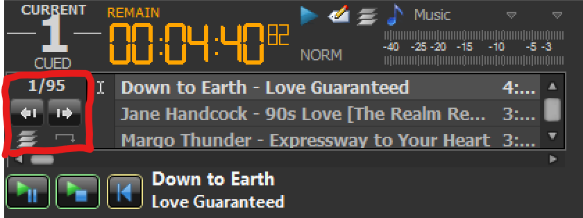

The play mode of the stack can be adjusted using the buttons to the left of the mini playlist.
In automatic mode the tracks in the stack are advanced and played one after the other (might also be looped endlessly).
In manual mode the tracks of the stack are played individually (but once a track is played the track in the stack is advanced).
