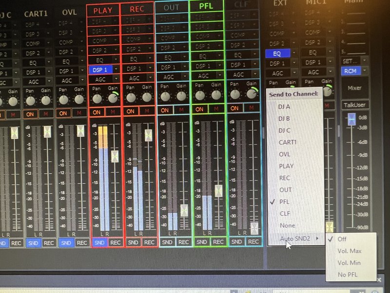

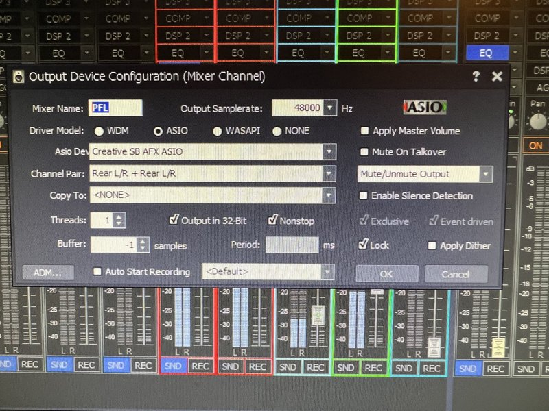

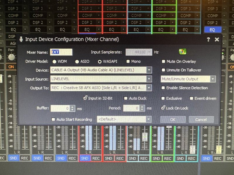

Thank you for your response. I believe that's what I did, but it isn't working (see the photos of the Input channel settings (SND button is hide but actived) and the photo of the Input the PFL channel settings, and my apologies for the photo quality).
1/ Did I make a mistake in my configuration?
2/ What action should I take to get the sound in PFL?

It looks, like your fader of the input mixer channel is totally down - so you can not hear anything. Ie. the fader needs to be up.
May be in your workflow you might want to flip the config of your REC and PFL use. Ie. set the default ‚Output To‘ to the PFL channel. And use the SND to connect it to your REC output.
This way you can always pre-listen, but only use the input effectively when you activate SND ?

What is SND is always post fader.
That’s why I advice to just flip your ‚Output To‘ and PFL config.
What is your reason that you don’t want to flip your config?

I didn't quite understand the configuration you adviced
Now I tested it and it works. Flip it gives me what I want. It's great but there's one problem: in my headphones, I hear the general output at the same time as the channel Input signal (it doesn't cut the sound of the general programme like when I pre-listen to the sound of a deck).
Would you have a solution to avoid this?
Re: How to get PFL on Input Device?
You can deactivate the SND of the given output
Mixer channel.
