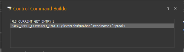

I am creating a script in ProppFrexx script editor:
This script looks like this:
#2 is a self created python script that creates an MP3 file used in #3
I would like to use the trackname of #1 as parameter in #2
My plan was to use the command PLS_CURRENT_GET_ENTRY to get that information
But how do I use the result of PLS_CURRENT_GET_ENTRY in EXEC_SHELL_COMMAND?
It is possible I am thinking in the wrong direction here, if you have any better suggestions it would be greatly appreciated.
Re: Using result from PLS_CURRENT_GET_ENTRY
First note, that a script-line is executed when the line is executed and NOT when the track is played. I.e. when a new track is requested from the playlist to be schedled to a playlist - this is sometimes timing wise 3 tracks ahead of its play time.
Regardless, the _GET commands are typically designed for external applications to query a result.
But internally they can not be used to retrieve a result.
For this you need to use script macros. On this case the "*[EXEC:{controlcommand}]" macro.
This macro actually returns the reply of a control-command.
For example you can omit your 2nd Command script-line and instead use the macro in your 3rd LoadTrack command, e.g. like this:
LoadTrack, C:\Elevenlabs\*[EXEC:{EXEC_SHELL_COMMAND_SYNC C:\Elevenlabs\run.bat xyz}].mp3, Count=1
This assumes, that the batch returns xyz and not the extension - that's why I added .mp3 as well.

Thanks for your answer, but how do I let run.bat know what the trackname of the previous track was?
Please note that the runtime of run.bat is around 10 seconds. It is not possible to let it run after the track ends.
I am afraid, that this is currently not possible.
