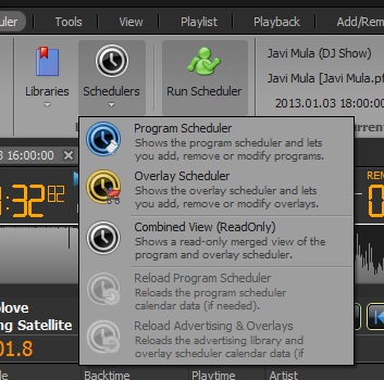

how do reload Advertising and Overlays.
I have it blocked. How to do it?
Marian
Marian
- reload.jpg (52.32 KiB) Viewed 8981 times

The 'Reload Advertising & Overlays' is disabled in two cases:
1. it hasen't changed since the last reload
2. you do not have the right (e.g. not using the Enterprise License)

As said, the 'Reload Advertising & Overlays' is only enabled, if a reload is needed - meaning, if some data has been changed.
If no advert data has changed or no change was made in the Overlay Scheduler, there is no need to reload it and as such the button is disabled.
Note, that when you open the 'Overlay Scheduler' calendar directly from within ProppFrexx ONAIR its data is already reloaded and up-to-date.
So what advert data did you exactly change and how do you do that exactly - so that you believe a reload is actually needed?
