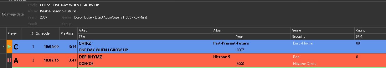

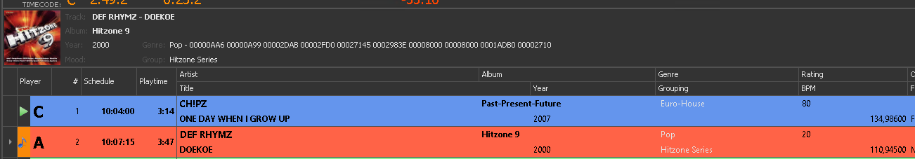

Dear Bernd,
I got the following situation. In my media library, I mark songs that I absolutely do not want to play with a rating of 20. In my script, I filter out those songs.

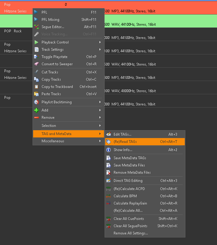

Every now and then, a song is being played with a rating that I know is 20. However, Proppfrexx only recognises the rating after I re-read the tags (See the image).
How can I make sure that Proppfrexx reads this tag properly? The tag is by the way edited via Proppfrexx itself.
Let me know how I can provide more information.
Best regards,
Thijmen
Best regards,
Thijmen
