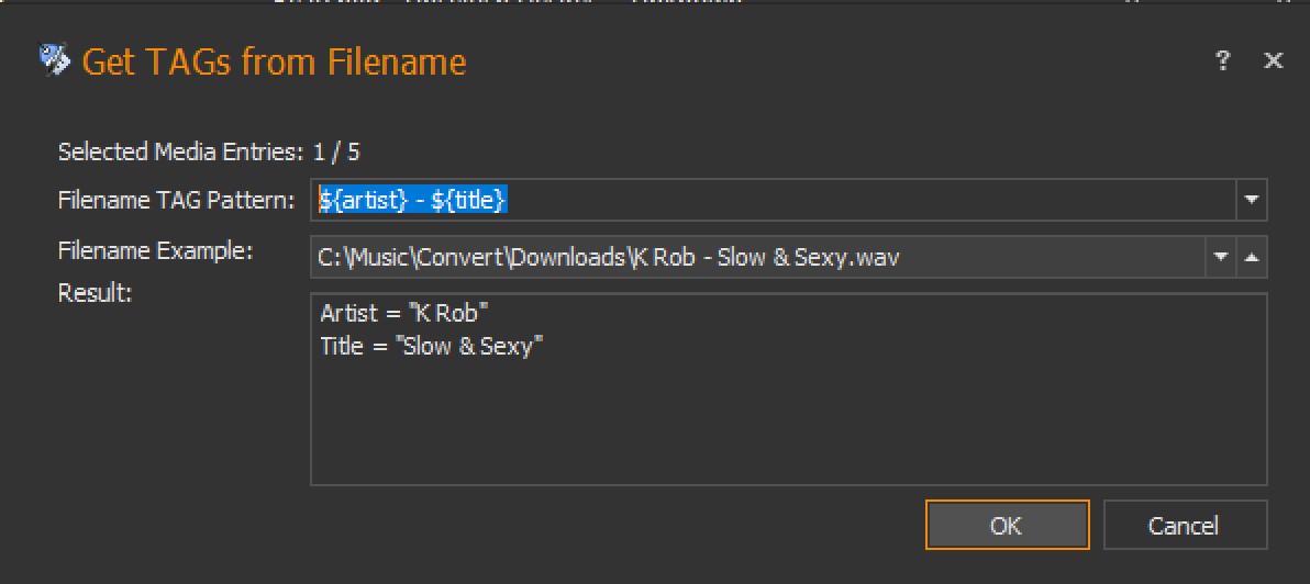

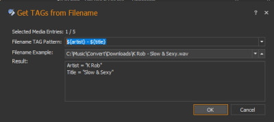

Why so complicated? Just use the existing Tagger application (ProppFrexx Tagger.exe) and open the folder containing those audio files - then select then and right-click on Selection -> Get TAGs from Filename...
In the upcoming dialog you can specify the filename pattern to extract the TAGs...

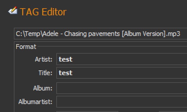

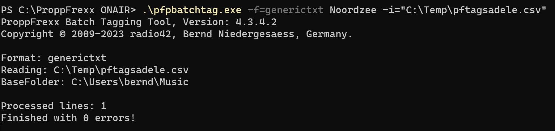

Unfortunately there was no .mp3 file attached. So I used my own test file which I renamed to your filename ("Adele - Chasing pavements [Album Version].mp3").
But I could not experience any issue:
But I saw a '__MACOSX' sub-folder in your Archive.zip - so could it be, that you are processing it on a MACOSX file system and that the square brackets are problematic using Parallels - as I am using a Windows Filesystem?
Have you tested it under Windows as well?
Or are all filenames using square brackets problematic on your system? As under WIndows they are not!

Unfortunately I can not say what might went wrong on your side, as with all my tests it worked fine here. As you can see above…
But glad, that all tracks are now tagged correctly again.
