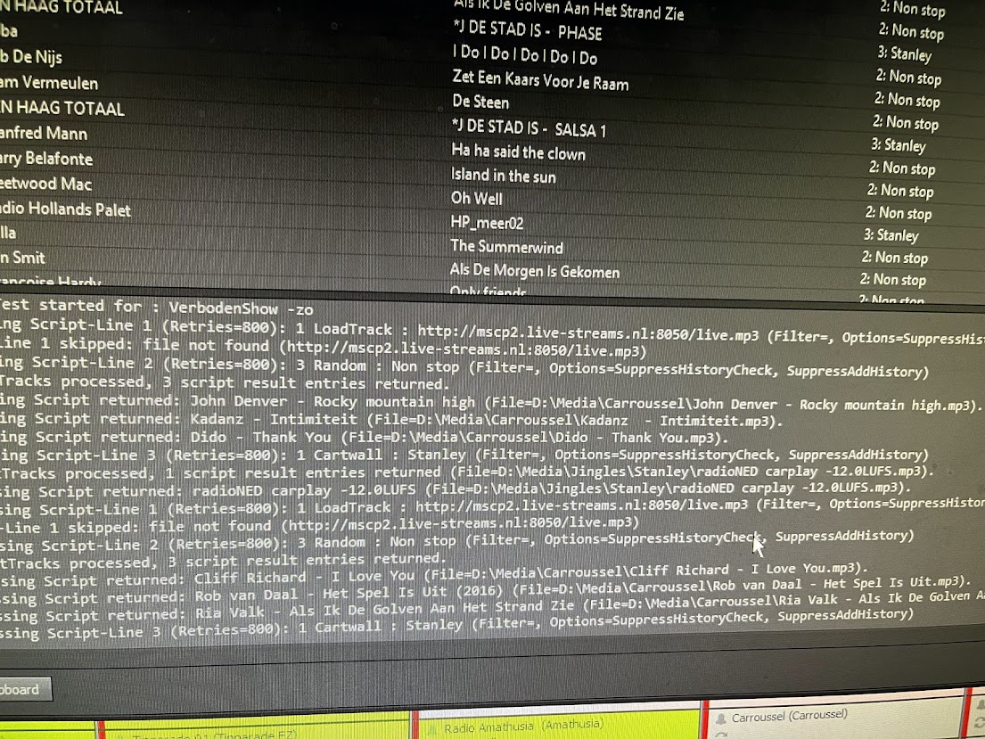

Hello Bernd,
When i start a script with a external live stream the script line where the live stream URL is gives 'file not found'
But i am sure that the live stream URL is good and working. Because when i put the live stream URL in the mod watcher there is audio
So the live stream URL is ok.
And since yesterday no one of the live stream programms is working anymore.
Wim

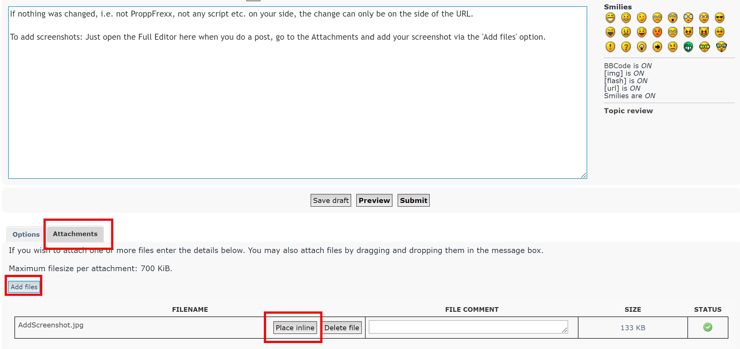

To add screenshots:
Just open the 'Full Editor' here when you do a post, go to the 'Attachments' and add your screenshot via the 'Add files' option.

Here are the screenshots. The URL is ok because with the MOD Watcher Player is works fine with audio!
Wim

However, I found the solution.
You just updated to the latest ProppFrexx version, which indeed contained a bug.
It is now fixed in the v4.3.3.10 version!
