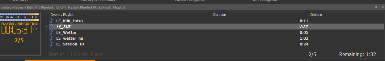

I took some screenshots. Maybe this helps to clear my problem.
I don´t know why the duration doesn´t change, when the file was change?

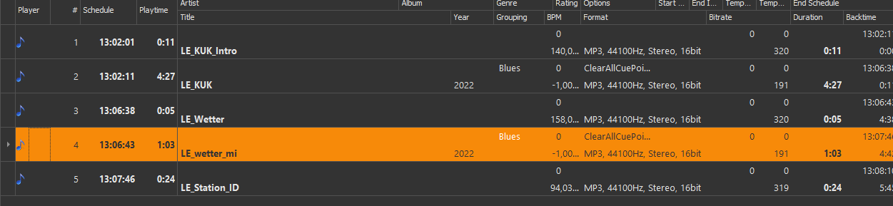

I took the wrong picture of the playout view. Here the correct.

Now I got your issue. And yes, this is correct. When you assign a playlist to an Overlay, the individual playlist items/tracks are not (re)evaluated before loading them, ie. an overlay playlist is used as is - even if the underlying entry has changed.
Thus, it is correct to use the Script mode for your Overlay.
