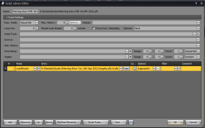

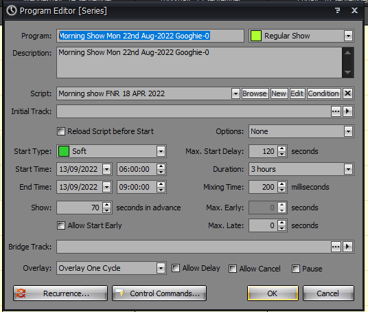

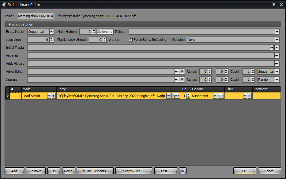

We are having an issue where a scheduled playlist isn't closing at the time when it is supposed to. What happens then is if another playlist is open it will automatically begin to play, meaning two things are playing at once.
When a schedule is supposed to end the playlist isn't closing so both are there.
Attached are some pictures of the scheduler and a script we have set up.

Why have you defined the program as ‚Overlay: Overlay One Cycle‘?
This setting actually prevents the previous playlist from being closed - as this means, that this program should overlay the previous one. On top you did not check the ‚Pause‘ option.
To resolve your issue: Clear the Overlay option and set it to None.
For more info click on the ‚?‘ icon at the top right to get more help about these settings.

You might have misunderstood the concept.
What you experience is a kind of side effect, but not a solution to your initial issue.
Your initial issue is, that your playlist (1st script-line) loops, in case it is too short. And this behavior is by design.
BUT there is a very simple solution to it (which is also by design).
You simple add more script-lines (at least one) to your script and set the Loop-Line option in the script to 2.
This means, that the script, if it has to loop, will only loop starting with script-line 2.
I.e. it will skip the first script-line.
For the overlay options (which are not needed in your case), pls click on the ‚?‘ icon at the top right of the dialog.

A program/playlist plays, until a new/next program starts.
So have you defined a next program in your Program Scheduler?
For example your DJ Show runs from 15:00 to 17:00, you need to define a new program at 17:00 to start your automatic program again.
E.g. can you show how you defined your programs in the scheduler?

Still, you should not use the Overlay function.
If you have no Next program to be scheduled, you can set the Scheduler to the non consecutive mode (in the general settings). In this mode a program/playlist stops at the defined End Time of the program, instead of with the start of the next program.
