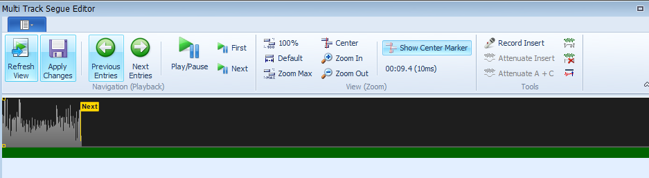

It took some time, but now I know the mixing problem isn't a mixing problem.
The "problem" is the button PFL Mixing. I use this button to test the mixing.
My guess:
The embedded container is much larger than the length of the sound.
The sound is, lets say, 10 seconds, but the container is 30 seconds. Look at the screenshot of the Seque Editor, there's a lot of empty space. Maybe that's the problem?
At default the button PFL Mixing it's set at 3 seconds. When I change this to 20 or 30 sec it works fine. But I think that's not a real solution.

Re: Previous UseHookCuePoints as regular track
You are correct, there was indeed another bug regarding the PFL Preview and Segue Editor Wave calculation for embedded containers.
It should be fixed with the new v4.3.1.2, which has just been released.
