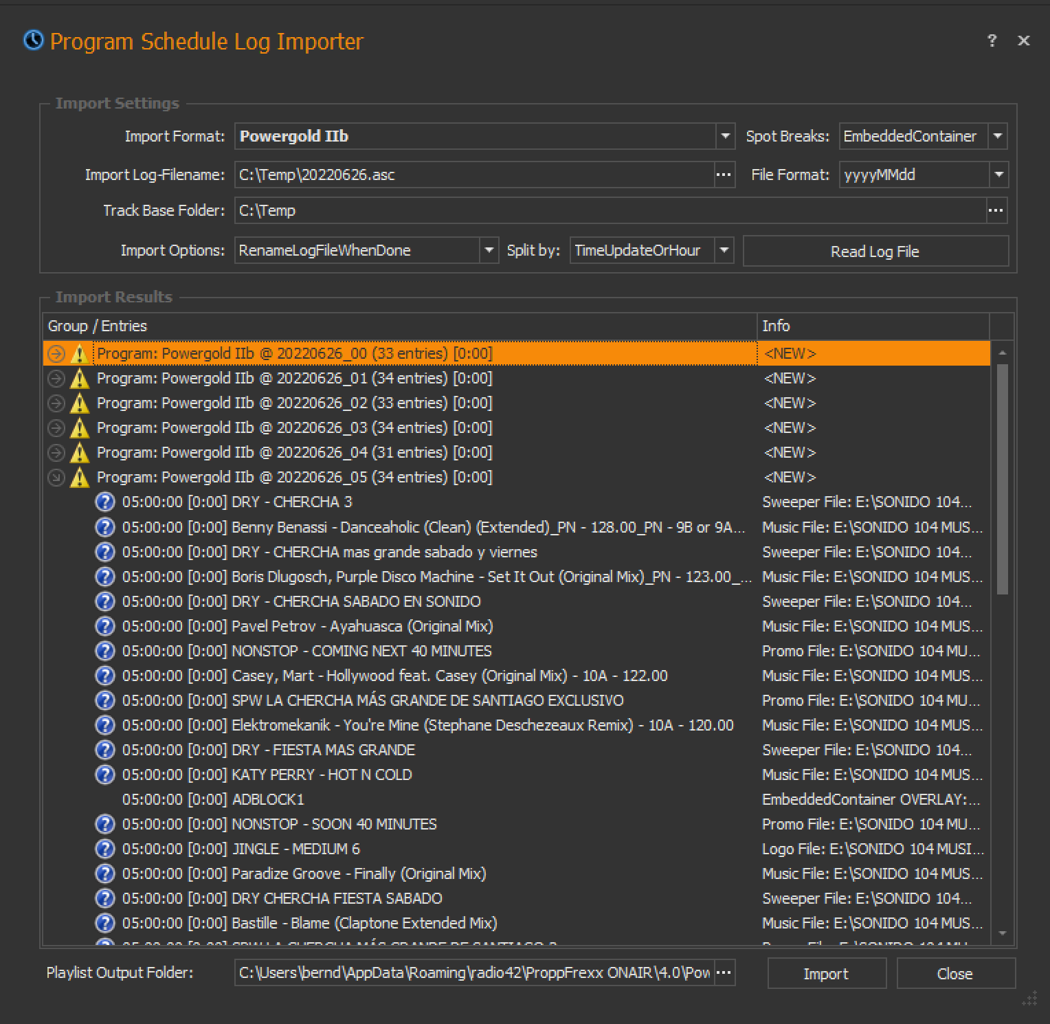

Hello,
I am configuring Powergold Export and ProppFrexx Log Importer using PowerGold II preset, the import seems to work because it is identifying all the filenames but ProppFrexx does not split the log by hours using TimeUpdateandHour.
Here it is the proppfrexx.importformats file and the export file from Powergold, I think there's a mismatch that I am not seeing.

Re: Problem Log Importer
Sorry for the late reply, but I did oversee you post (as it was in the unmoderated part of the forum).
However, your log-file does not fit your imports definition resp. the import format definition doesn't match your log file.
E.g. note, that the fields start position start with 0.´and not with 1 and the length also seems incorrect.
Examples:
You specified:
<field name="Title" start="0" length="50" align="left" pad=" " format="String">${X}</field>
<field name="Artist" start="50" length="50" align="left" pad=" " format="String">${X}</field>
<field name="StartDateTime" start="157" length="14" align="left" pad=" " format="DateTime:yyMMddHH:mm:ss">${X}</field>
But it must actually be:
<field name="Title" start="0" length="49" align="left" pad=" " format="String">${X}</field>
<field name="Artist" start="49" length="49" align="left" pad=" " format="String">${X}</field>
<field name="StartDateTime" start="155" length="14" align="left" pad=" " format="DateTime:yyMMddHH:mm:ss">${X}</field>
These are just examples, but actually all field start positions and length have to be adjusted/validated.
I guess this will also solve the splitting...
Here is the correct formats definition for your .asc file:
    <fields>
      <field name="Machine" start="98" length="2" align="right" pad="0" format="int">${X}</field>
      <field name="Magazine" start="100" length="1" align="left" pad="0" format="int">${X}</field>
      <field name="Slot" start="101" length="3" align="right" pad="0" format="int">${X}</field>
      <field name="Misc" start="104" length="32" align="left" pad=" " format="String">${X}</field>
      <field name="CDNum" start="136" length="4" align="left" pad="0" format="String">${X}</field>
      <field name="CDTrack" start="140" length="2" align="left" pad="0" format="String">${X}</field>
      <field name="RunTime" start="142" length="5" align="left" pad="0" format="TimeSpan:MM:SS">${X}</field>
      <field name="RunTimeSec" start="147" length="4" align="right" pad="0" format="int">${X}</field>
      <field name="IntroSec" start="151" length="2" align="right" pad="0" format="int">${X}</field>
      <field name="EndingStyle" start="153" length="1" align="left" pad=" " format="String">${X}</field>
      <field name="DayOfWeek" start="154" length="1" align="right" pad="0" format="int">${X}</field>
	<field name="EventType" start="169" length="3" align="left" pad=" " format="String">${X}</field>
	<field name="CueType" start="172" length="1" align="left" pad=" " format="String">${X}</field>
	<field name="FilePath" start="173" length="200" align="left" pad=" " format="String">${X}</field>
    </fields>
And then it works, I just tested it...

Format adjusted in the .asc and importformats file, the splitting is working partially (skipping every three hours) and the files are not being identified by filename.
Seems, that all your filenames could not be resolved as audio files?! Eg. the path in the log file is not accessible (E:\…)?
This also leads to the fact, that every is seen as a Document Entry with a zero (00:00) length.
So please check your file path and location.
And...
you probably imported a different log file with different/wrong data. I just imported the log file you provided above and that perfectly worked (obviously the duration of each entry is still 00:00, a it couldn't resolve the correct audio files, but the hour splitting worked like a charm):
