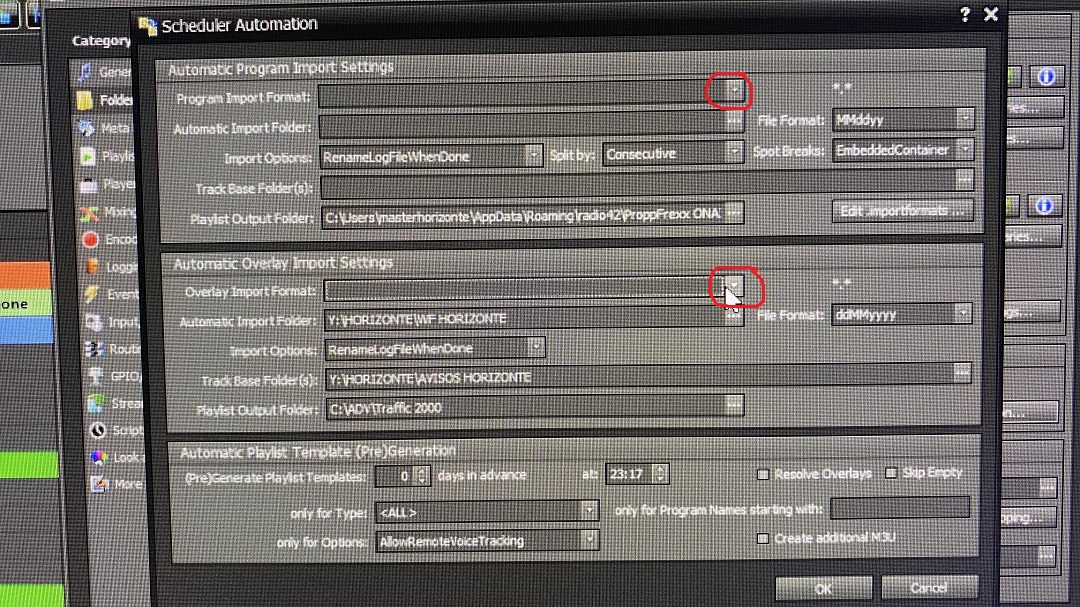

Hello,
Maybe someone else has happened the following:
In the field: Automatic Overlay Import Setting, it does not allow me to make any selection.
My Radio station works with Traffic2000. A couple of weeks ago, if it worked fine, but apparently after upgrading to version 4.2.4.1 the integration with traffic doesn't work for me.
I only modified the .importformats file to change from .txt to .asc and in addition to the field numbers to be able to read the .asc
Apparently this file is broken.
I appreciate if someone can help me.
Alejandro Parada
From Chile.

As already replied on your mail...
You have changed your .importformats file manually and thus corrupted it. As a result it became invalid and couldn't be read anymore. Ie. the is NO bug in the software, but it is a configuration error, which you need to adjust it accordingly.
Beside the changes you have mentoned, you have also changed the format.type value from FIXED to SOFT. But this not correct, as the format.type value does not specify the program or overlay start type, but the FORMAT type, which is either FIXED or CSV.
So please change the following configuration line - from:
<format name="Traffic 2000" type="SOFT" extension=".asc" ...
to:
<format name="Traffic 2000" type="FIXED" extension=".asc" ...
As you can see the format type can only be FIXED or CSV.

Effectively, that's right. That was the whole problem.
I greatly appreciate your response. And I apologize for posting it in this Bug section.
It was my first post and I did it in the wrong place. I apologize again.
The system works very well. The error was mine when modifying what you indicated to me.
