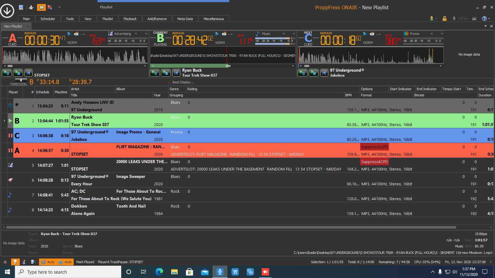

This is what i have now
no mixer no clock

Looks like you might have closed all other docking windows.
What happens, if click on the View ribbon tab and than click sind n eg. the Mixer window button?
This would normally make them visible again, except you have moved them to an invisible location. In that case please Reset the Layout in the general settings, section Look and Feel.

Bernd Going to layout in settings, hitting restore and restarting did not bring back my mixer or the clocks. What do you suggest I do next?
Re: mixer view
That sounds impossible and might indicate a more serious issue. Than please try it manually;
Closer ProppFrexx
Go to the ProppFrexx AppUserData folder
Delete the file called “ProppFrexx ONAIR.layout”
Start PropoFrexx
Now you should have exactly the default layout as after a fresh install. And this is exactly what the above button click should have done.

Bernd It worked i hit the wrong button thanks
