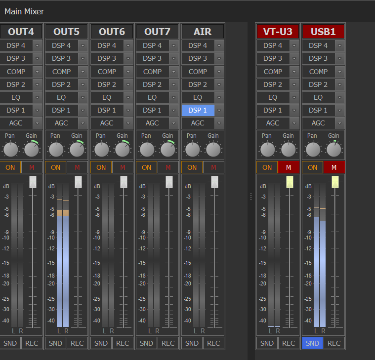

Nope, not muted. Fader is up.
Re: Problem creating mixer output setting
Oh, but there screenshot shows that it is muted!
See the ‚M‘ button above the fader, which is dark red!
Click on it to unmute.

Wow, I feel really stupid... :x
It works now... I was under the impression it wasn't muted, since the meters showed volume and I did receive audio input...
