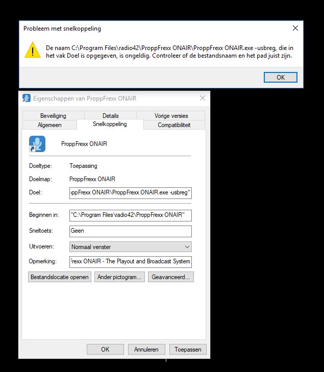

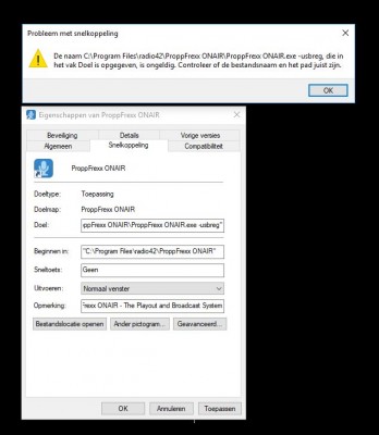

This gives a fault Image
Run as admin
Re: Startup
Move the -usbreg outside the quotes!
Only the path and filename needs them.
