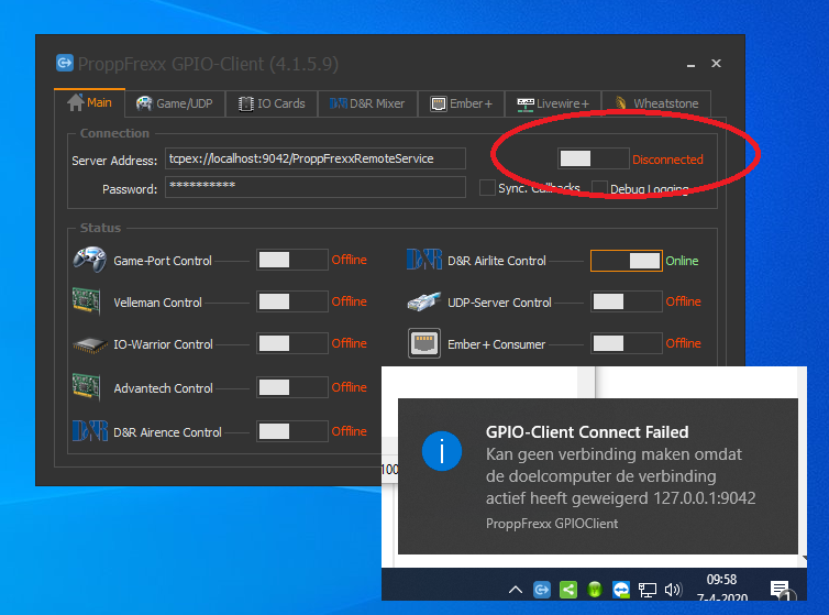

1st question:
See the attachments.
What is red circeled: this is going on and off.
And the connection failed comes.
The question is: Is this only for remote control ? Because i use my airlite on the pc where propffrexx is installed. So, i should not have a problem with this ?
Note: When i monitor at the airlite in gpio, every button i press, i got tekst, for example: MSG: STATE_ON_AIR. 1 = 1

Answer to 1: I think it might be your "password" that is not the same as in Proppfrexx On air. (I JUST THINK !)

for 1: beside the password (check this with your ProppFrexx ONAIR password in the general settings, section GPIO, under TCP Device - Authorization Password) - you might also completely remove the text in the GPIO Client field 'Server Address'. The system should now automatically discover the existing ProppFrexx ONAIR service in the same computer and populate the address itself again.
Also make sure, that you have enabled the GPIO Ext. Service on the ProppFrexx ONAIR side!
for 2: maybe the issue is simply 1).
If the GPIO client is NOT properly connected to ProppFrexx ONAIR (and the On/Off switch indicates this) it won't work.

Aaahhh!! I didnot know that you have to enable gpio at general settings, so i startup manually the gpio tool. But now i enabled it at general settings i notice that the gpio tool automatic startsup with it. And..the error is gone..and..now it work fine with the commands to configure the buttons. Many many thanks!
