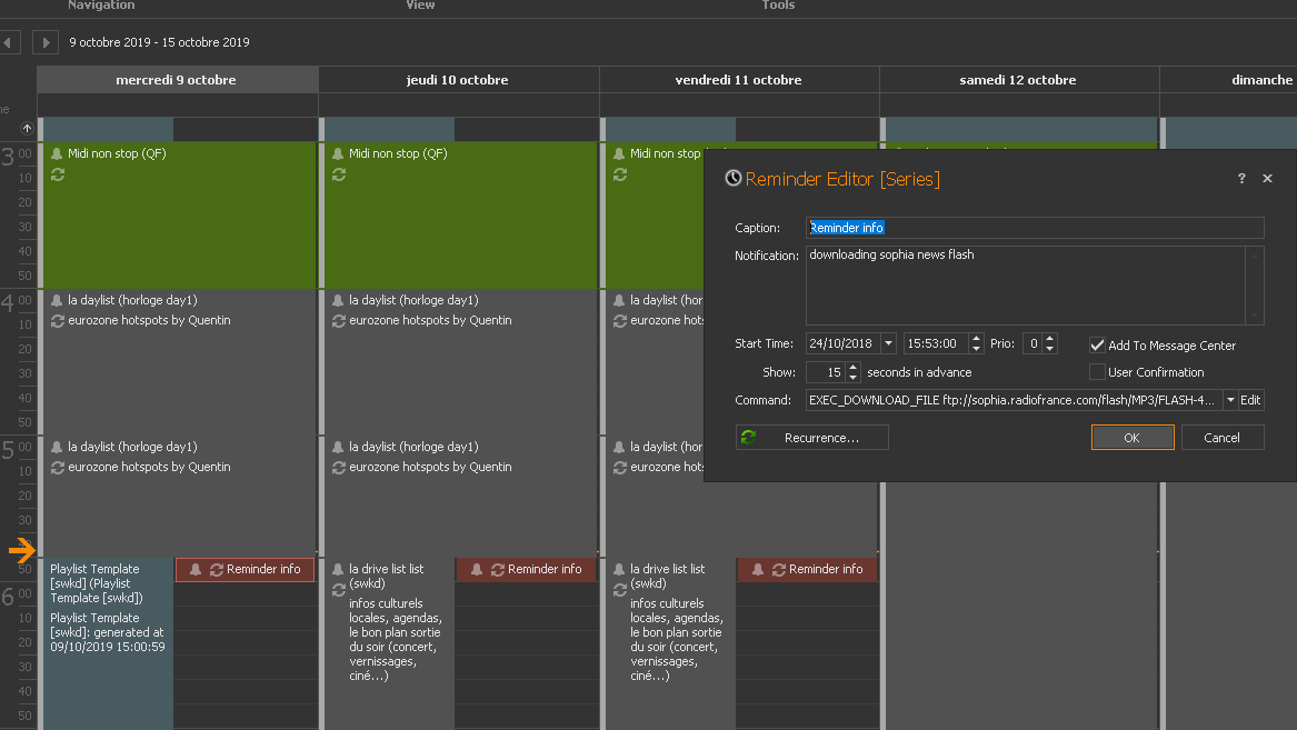

some more
message reminder.PNG (8.26 KiB) Viewed 10473 times

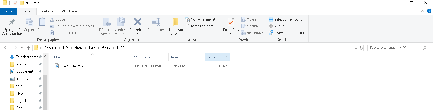

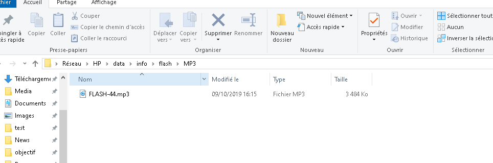

Re: news ftp download time problem
Post by moogwill »
No cap of the file right after he download but was exactely like the one of the previous... complete.. just vanished 2 mn after....

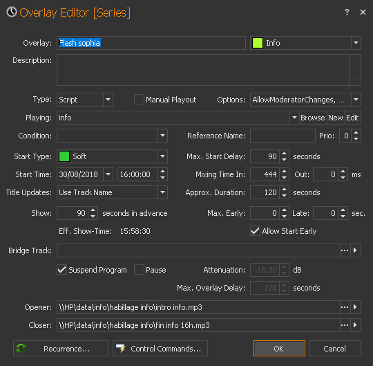

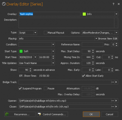

Post by moogwill »
here's the overlay

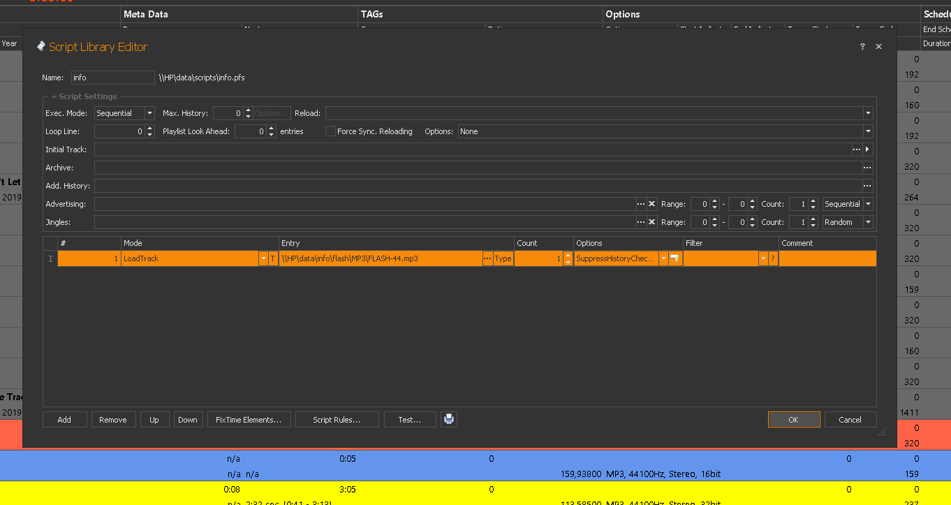

Post by moogwill »

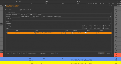

and here's the script that is loaded in the overlay

I'm not sure, but i think I just found the cause... My fault
Another instance of propfrexx in our third studio was scheduling a download of the same file as it was in use with this one...
I jsut closed it to see if it is correct for 6pm news..
Let see then...

I think I was right.. that was absolutely my fault... sorry (but the issue of the late download is solved)

the error was from the other instance of `proppfrexx. that was overwriting the correct download.
Seems it was correct at 6PM will see tomorrow mor,ing now
