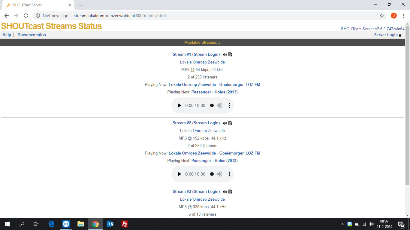

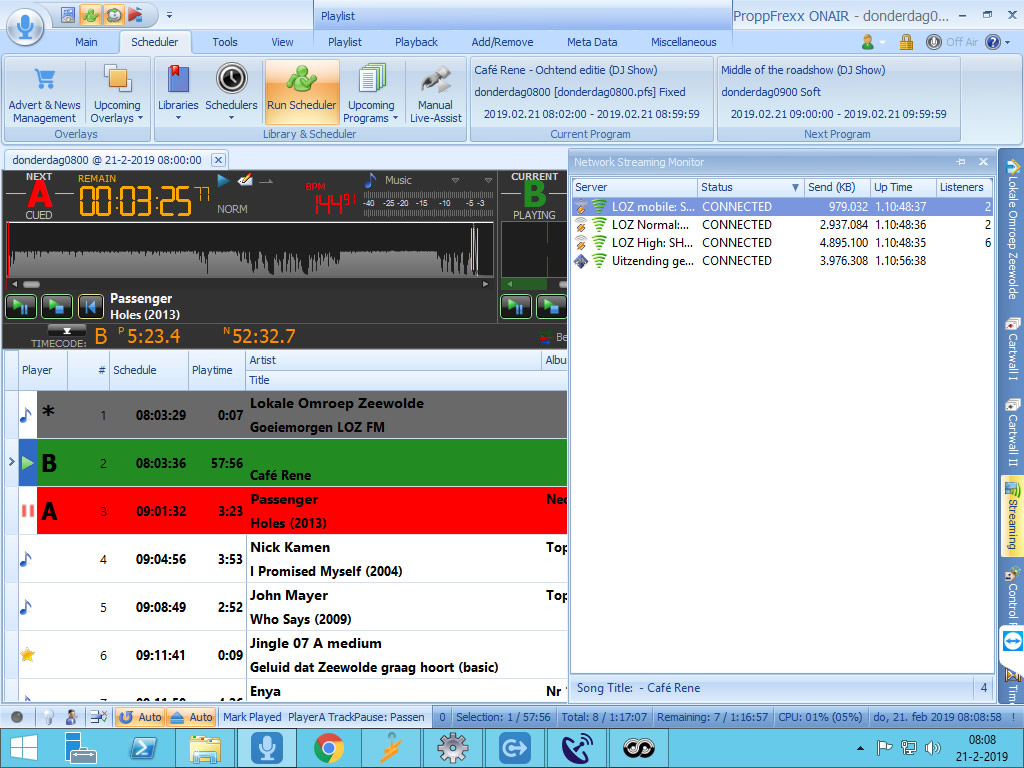

As prommissed an update from our test we have run.
We have tried the T botton, but without succes.
The program is correctly displayd in the player, but shoutcast can not handle it, and remains at the initial track which is selected in the script.. So for us i assume that the best thing we can do is to use the command line..
PF with program name
shoutcast display initial track from script (using t-option)
Re: OverlayName @ titles update
I am sorry, but here it works, as you can see from my pictures above.
Maybe you have excluded that related track's music entry type from the song title updates.
Post by jbmusic »
i know that it is working for you...
the strange thing is that i have exclused Jingles, commercials, promo's from beeing displayd but the initial track is marked as jingle but this is shown instead of the next track name...
The most strange thing is, that this only happends on file's which are longer than a regular song...
Could it be, that the transition which should be done is causing a block?
A regular playlist is changing after aprox 3 min... and now he holds til 58 min.
