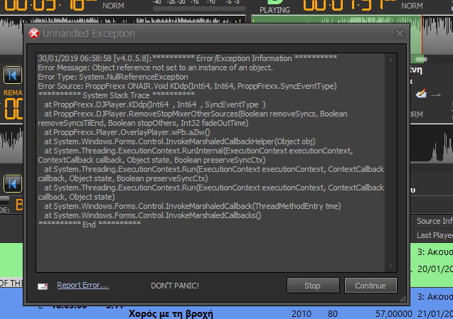

Just for your info (v4.0.5.8)
Today whille PFOA was playing unattended the next window popped up:
Re: Unhandled exception
Thanks for raising this issue.
Can you please send me you full ‚Error.log‘ file.
It is located in the ProppFrexx AppUserData folder.
Many thanks in advance, as I hopefully will then be able to track the root cause.
I took a look and it really looks weird, as at the position where the error was reported such an error can logically actually not really happen. Obviously it did regardless. But I guess I can still spot the possible error, which might only be a extraordinary rare race condition, meaning, the problem is not specific to the latest version, but would have been in for ages, but never really ever happened before.
I correct that soon and ship a new version.
Should be fixed in v4.0.5.9-beta
