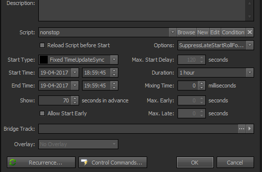

Can you please show me a screenshot of your new program scheduler entry to take a look at to try to replicate it here on my side, as so far I cannot reproduce that here.
Plus, how are you scheduling the URL stream, is that via a previous program's script? If yes, can you also post that related script-line (e.g. have you defined a length for your stream?).

I guess I now see the issue. It is however NOT related to the KeepStreamAlive or KeepStreamLoading options.
You are probably using a SoftTimeUpdateSync with your next program?
If yes, please try a FixedTimeUpdateSync when using a URL stream before. A URL stream would currently be always fully played out when using a SoftTimeUpdateSync with a next program - which is indeed not totally correct.
I will adjust this in the next version!

Line 7-9 is for extra safety
Thanks :)

More options in the script line, not visible in the screenshot:
SuspressHistoryCheck
SuspressAddHistory
Duration is set by PF to 23.59:59
I cannot set an exact length, as I don't know when the program starts (due to news, commercials and so on)

Let's hope the issue is with the long duration. I've set the duration to 2 hours - let's see what happens next time we have the show.

Unfortunately I cannot see your stream script-line. Especially what options you used with it, eg. did you specify a length/duration?
If not please do that, as already explained.
Re: KeepStreamAlive' and 'KeepStreamLoading
But that is 25h.
Maybe you should set it to something almost correct plus a bit of overhead, but not to a full day.
Anyhow, as said, with a SoftYUS I can reproduce your issue, but not with a FixedTUS and a reasonable duration.
