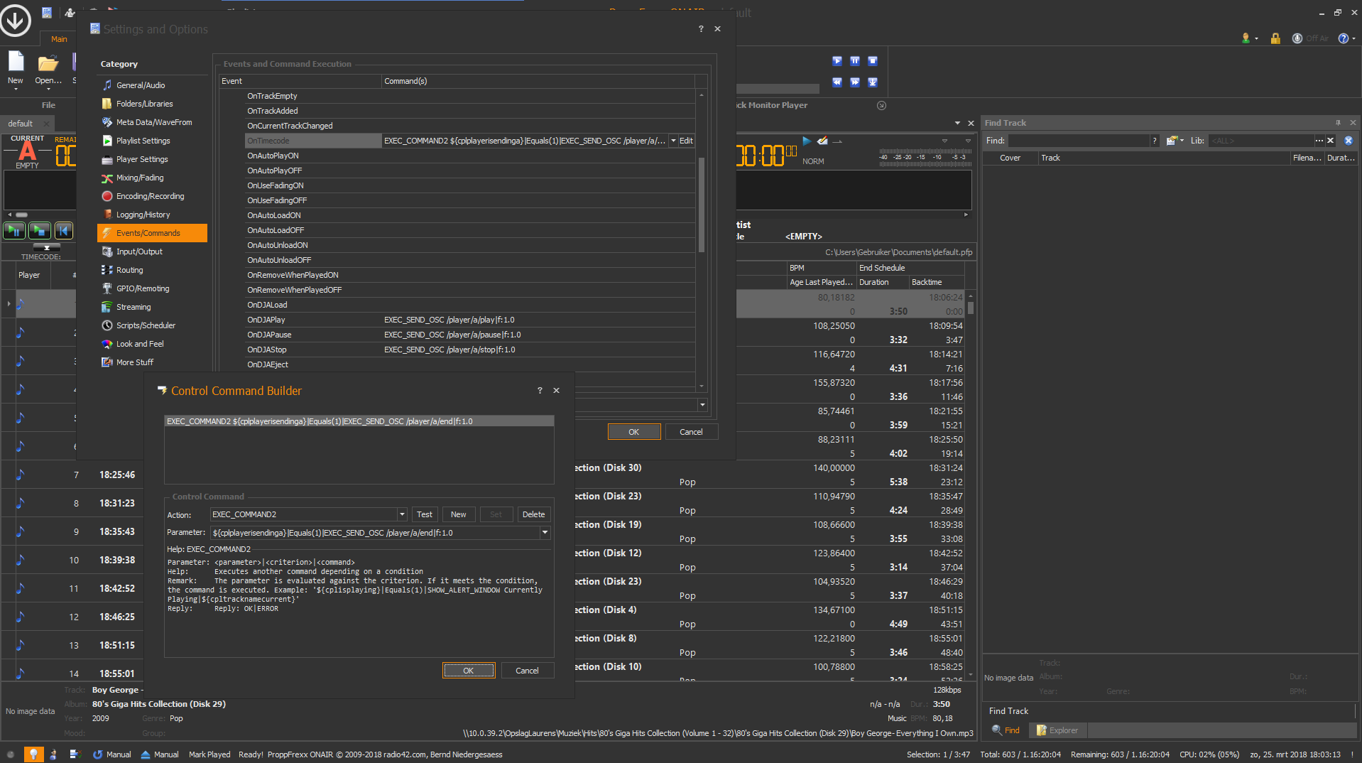

I want proppfrexx to send an osc command when one of the players is near its end.
Under the Playlist.onTimecode i placed the following command:
EXEC_COMMAND2 ${cplplayerisendinga}|Equals(1)|EXEC_SEND_OSC /player/a/end|f:1.0
But when i do this, the OSC command is sent when i click the play/pause button on a player, and not when a player is playing and the remaining timecode goes under 12 seconds.

Hello,
I exactly tried that solution.
Also see the attached screen shot.
A message is not send when a player is playing and gets to the end of the track.

Oh yes, I just see, that the macro currently returns "0" in case it is at the end, so it must be:
EXEC_COMMAND2 ${cplplayerisendinga}|Equals(0)|EXEC_SEND_OSC /player/a/end|f:1.0

Post by Laurens »
Just tested it and that is the solution. Thanks for your help.
