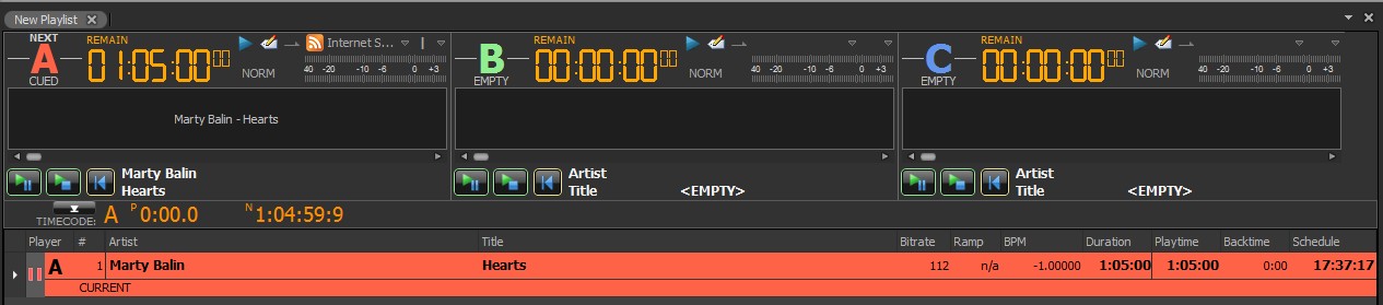

For BUG 1: It's any URL. Whatever one I can add. I've tried many. It adds, and will load and play, but the time is always wrong. I try to set it for 5 minutes each time, but the time set box ALWAYS puts a no. 1 like this: 01:05:00. I try to change the 01 to 00 but it automatically pops back to 01 so I can never set it right. It just keeps playing in the player for 1 hour or so. The other thing, depending whether it's set to AM or PM sometimes the player will play it for 20 hours or some crazy time. (This is why I don't like the time set box, it's too simple and does not allow for a clear setting of what exactly should occur when the playlist reaches this entry.) As I was trying again while writing this post, when I try to change the hours to 00, I see the default is 12:00:00 so I go to change it like this 00:05:00 but as soon as I hit the button to change the 12 to 00 it automatically changes to a 1 like 01:05:00. I can keep changing the 01 to 00 but AS SOON as I change it, it switches back. I hope this is better to understand.

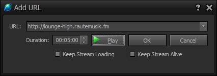

I still can NOT reproduce your issue here...if we are talking about the same dialog?!
Is this the one you are talking about? If yes, note, that the 'Duration' field does NOT have any AM/PM setting?
So I am really not sure what you are talking about?
As said, the 'Duration' is given in HH:MM:SS (Hours:Minutes:Seconds) - as seen above you might simply specify 00:05:00 for 5 minutes.
As such the URL is being played within the playlist for 5 minutes...
See attached Playlist picture... to 2:

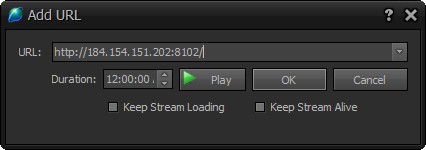

Ok, here are my screenshots: Set 1
- 2013-04-23_173614.jpg (13.96 KiB) Viewed 15849 times
- 2013-04-23_173601.jpg (13.94 KiB) Viewed 15849 times
- 2013-04-23_173541.jpg (13.85 KiB) Viewed 15849 times

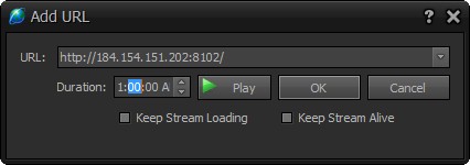

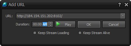

Set 2:
- 2013-04-23_173728.jpg (80.23 KiB) Viewed 15849 times
- 2013-04-23_173704.jpg (13.93 KiB) Viewed 15849 times
- 2013-04-23_173636.jpg (13.94 KiB) Viewed 15849 times

I hope you can see what I mean. I updated to the latest version last night but the problem remains.

Ya, in the last 2 screenshots where the #1 is highlighted in blue, that's the number I can't change. When I try to change it to #0 it just flips back to #1. And you can see the 'AM' there as well. It also can be changed to 'PM'.

Bug 2 is already 'resolved' in v3.0.11.44!
Bug 1 indeed looks funky on your screenshot (which is indeed different then mine) - I must investigate where this comes from!

I have found the issue
It was indeed a 'TimeEditMask' localization issue - it should now be fixed in v3.0.11.45 (which sets any time format to a fixed 'HH:mm:ss' format)!
