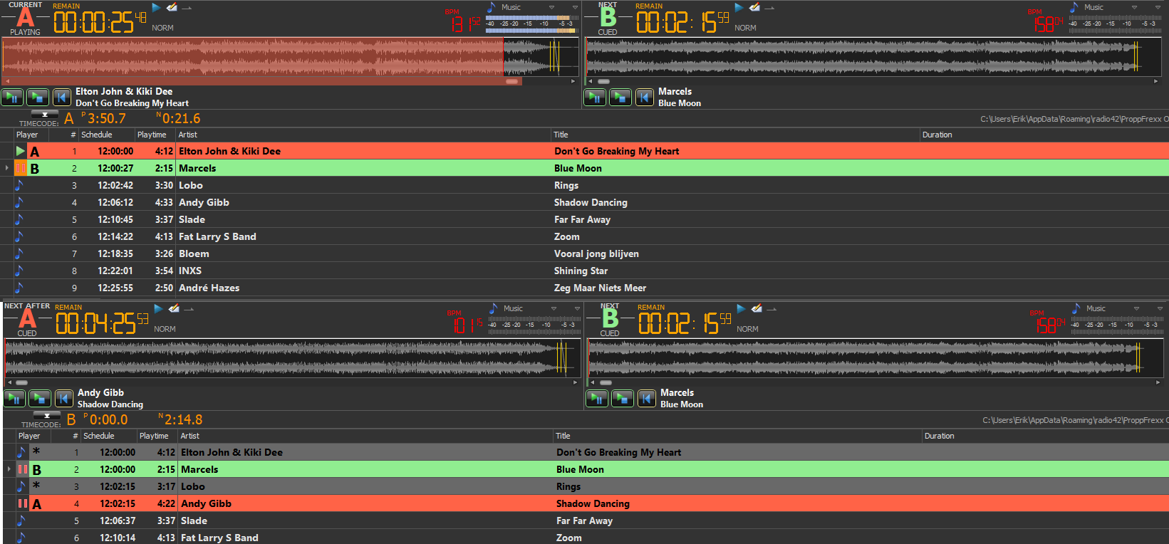

I have a question, if I start my players manually, via the start button on my airlite, and the record is over, it will start the next track again. However, it always skips 1 track, as shown in this image. What is the cause of this?
Both options are set to auto at the bottom of the screen.

I don’t know what is mapped and set with your D&R setup.
But I can only assume, that with your Start button, you may be also eject the current track, but that is already auto ejected and advanced to the next track, which is then ejected instead.
So please check your D&R mapping.
If you are using the standard mapping from Benjamin, note, that this is done for manual live assist, where maybe the automatic eject should not be turned on.
