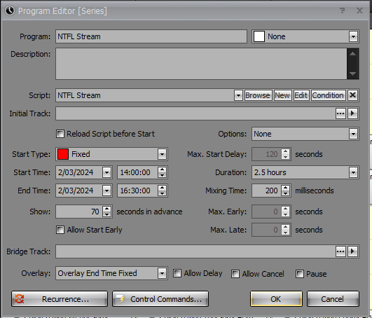

Hi, I'm having an issue with a scheduled live stream that isn't closing at the scheduled time.
It keeps on playing until someone manually kicks off the playlist continuing the stream.
Here are pictures of the settings:
We have tried Overlay End Time Fixed and Overlay One Cycle, as well as changing the start type from fixed to soft to auto.
It does not end at the scheduled time whatsoever.
Kind regards

By default, the scheduler runs in continuous mode (see general settings, section Scripts/Scheduler). This means, that the end time of the program is not concidered. Instead, the next program start defines when the previous program ends. Also take a look to the tutorial videos. Or click on the ‘?’ Of the dialogs to get more detailed help (tooltips).
This means you should define programs covering 24/7.
If this is not desired, turn the Continuous Mode of the scheduler off.
As the program is not an overlay of another program, leave the overlay option to No overlay.

I am sorry, but I can not follow what you mean. Can you please explain what you would like to achieve and what you have exactly configured. I see only one program scheduler entry (but not the ones around). And you have defined a script which loads two tracks and then loops on script-line 3.
