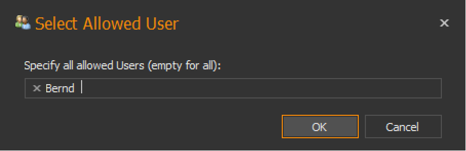

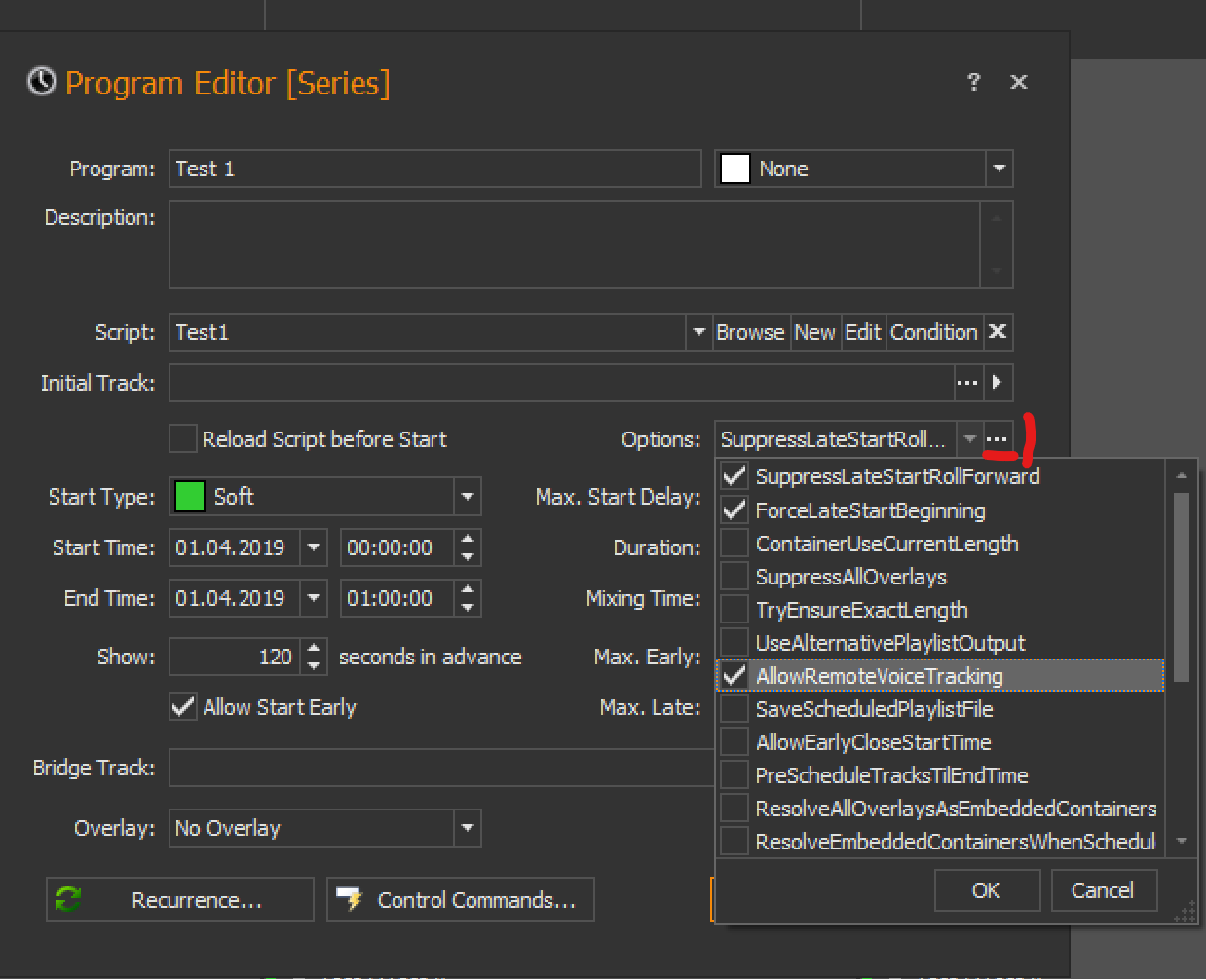

New list of allowed users for Remote Voice Tracking
You can now restrict the access and ability to perform remote voice tracking to specific users (which relate to the users as defined in the UAC; even if UAC doesn't have to be enabled, i.e. you can enable it to define the users and then disable it).
When you now activate the 'AllowRemoteVoiceTracking' option in the program scheduler entry editor, three dots (...) will appear at the end of the options.
Clicking on these three dots (...) will open a new dialog in which you can specify the user names allowed to perform remote voice tracking for this entry (if you leave the allowed users empty, all users are allowed):
When performing remote voice tracking (RVT) the user now MUST use this user name as the Clientname and password (as defined on the server's UAC) in order to be allowed to perform RVT on that program.
