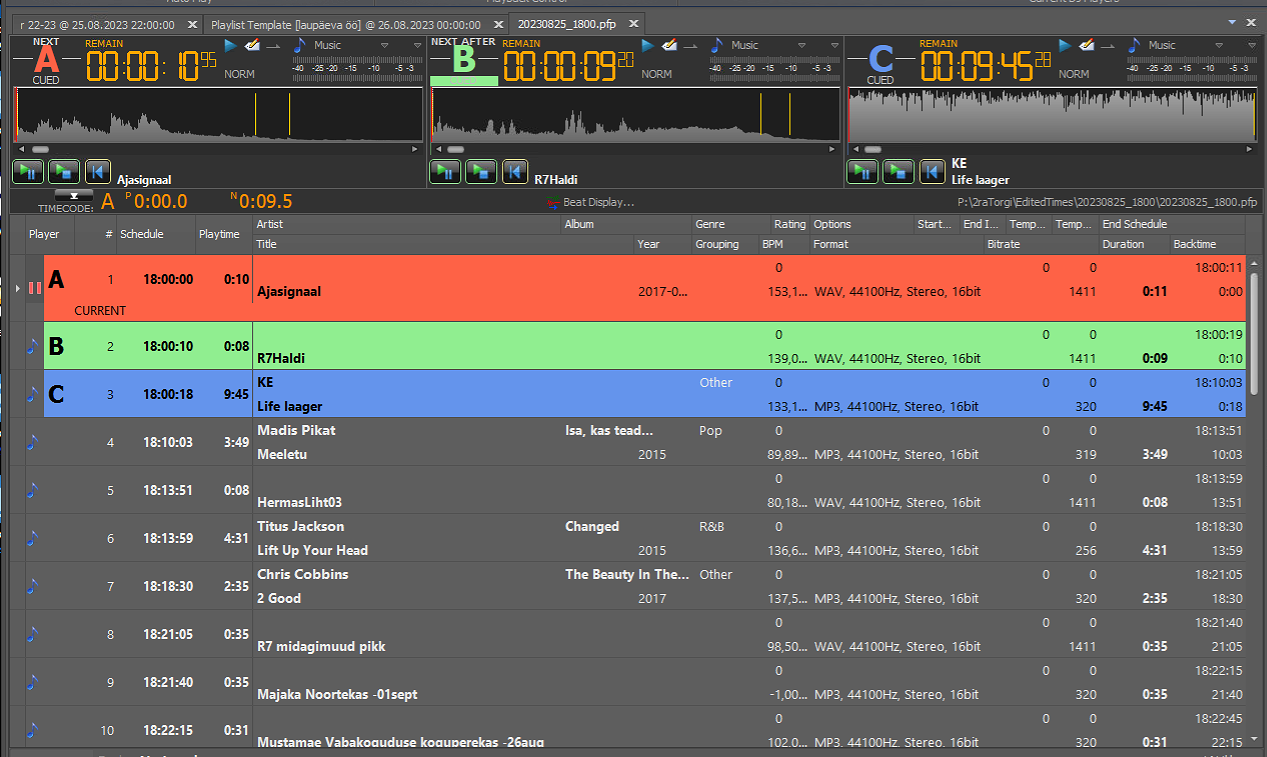

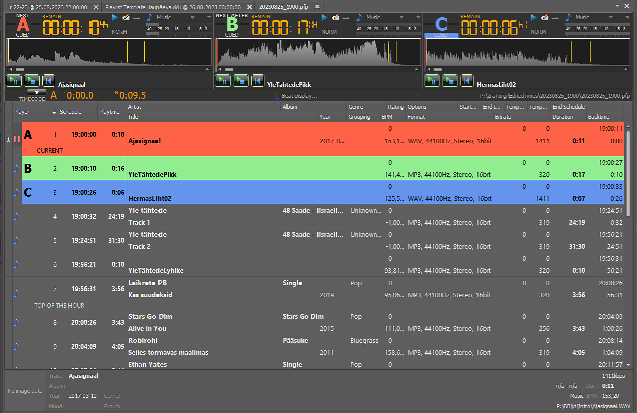

made some changes and added some track's In both hour
Opening like it's should be and example added
But when I watching to statistic's seems these Playlist templates did not work
There the tracks like in script on 18 & 19 hours in default

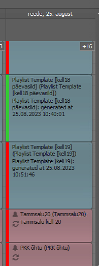

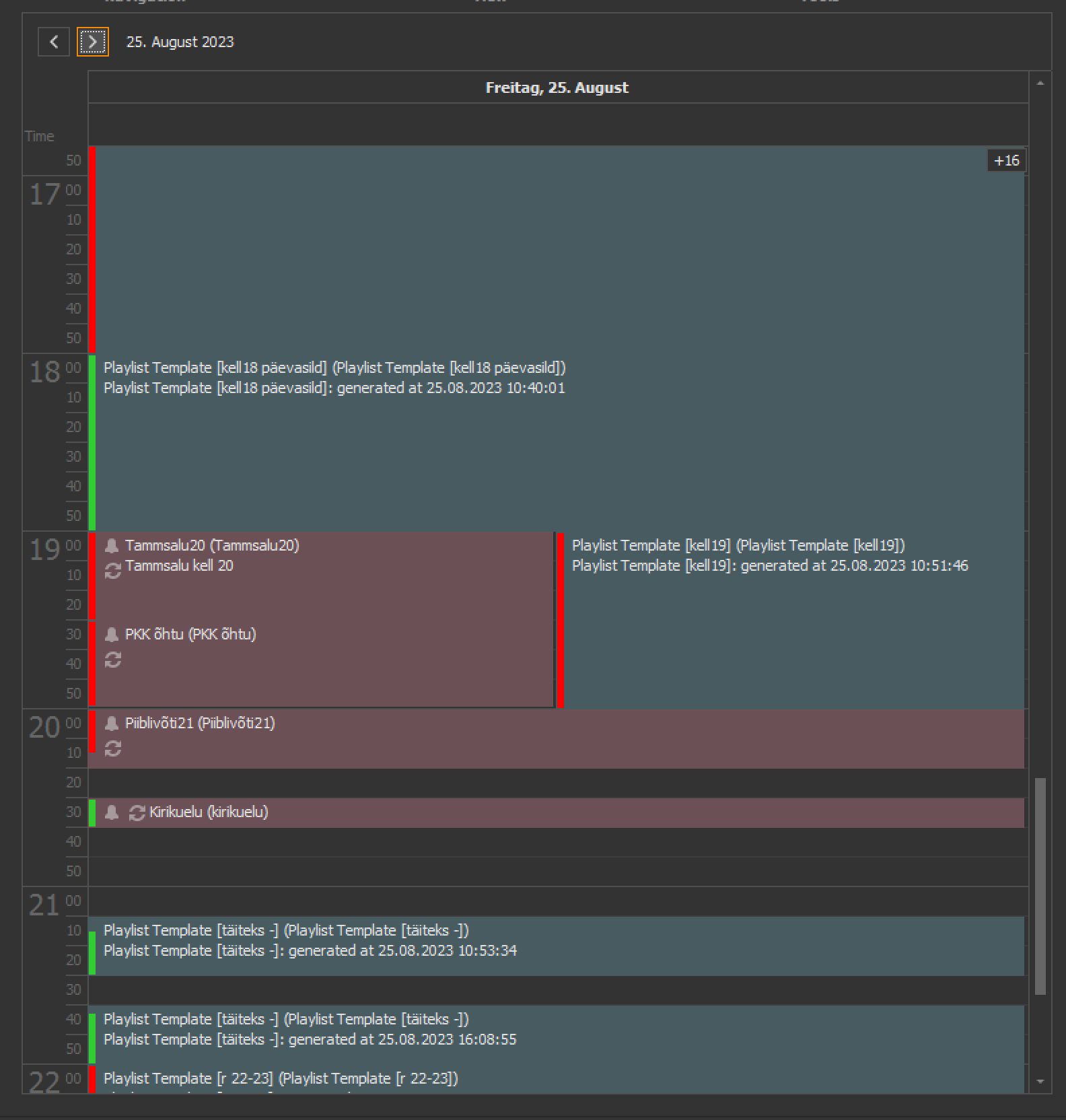

Thanks for sending the scheduler log and the .calendar file.
But the log and the calendar are not matching (see below). It looks, like they are coming from two different PCs. Different program entries than what is actually started. Plus you sometimes schedule multiple programs in parallel at the same time (this is not related to your issue, but still doesn’t work). They are still pretty similar…
So are you maybe using different PCs with different calendars (and these are not synced)?
Program Scheduler:
And Scheduler log:
25.08.2023 17:58:51: Program:kell 18 päevasild (kell18 päevasild), Start:25.08.2023 18:00:00, End:25.08.2023 19:00:00, Started:True
25.08.2023 18:58:43: Program:kell19 (kell19), Start:25.08.2023 19:00:00, End:25.08.2023 20:00:00, Started:True
25.08.2023 19:58:44: Program:Tammsalu20 (Tammsalu20), Start:25.08.2023 20:00:00, End:25.08.2023 20:30:00, Started:True
25.08.2023 20:28:45: Program:PKK õhtu (PKK õhtu), Start:25.08.2023 20:30:00, End:25.08.2023 20:59:00, Started:True
25.08.2023 20:58:45: Program:Piiblivõti21 (Piiblivõti21), Start:25.08.2023 21:00:00, End:25.08.2023 21:15:00, Started:True
25.08.2023 21:13:45: Program:21:15 (täiteks -), Start:25.08.2023 21:15:00, End:25.08.2023 21:30:00, Started:True
25.08.2023 21:28:46: Program:Kirikuelu (kirikuelu), Start:25.08.2023 21:30:00, End:25.08.2023 21:40:00, Started:True
25.08.2023 21:41:13: Program:21:43 (täiteks -), Start:25.08.2023 21:42:30, End:25.08.2023 22:00:00, Started:True
I assume you can spot the differences!
So what is executed and what you send me is definitely not the same...

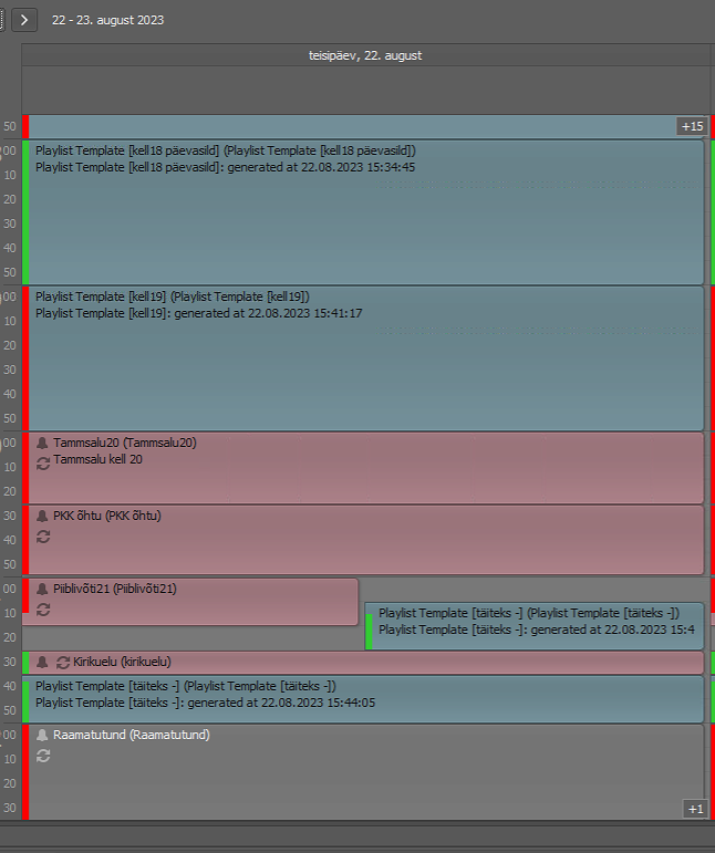

log what You show is 25.08, but calendar is 22
BUT - I added my 22 calendar - how my calendar is showing
In Your image some hours is "moved" to another hours
but all files related to one PC - -yes we managed program from three difference PC - but calendar for every pc is same with - globalconfig
right now when I looking how and where -- the 17 hour started script on schedule not the edited playlist template
Re: Don't playing Playlist template
Sorry, wrong file/screenshot - just corrected it - but that does NOT change much ;-)
When you maintain the calendar on 3 different PCs, note, that ProppFrexx does cache all data, i.e. when you make a change on one PC, the .calendar file is properly updated, BUT you must then 'Reload Program Calendar' - this does not happen automatically, except once a day shortly before midnight.
I.e. if you make changes during the day for that day, you must manually reload the data (or do it via a control-command)!
Are you doing that (from the logs, this is missing - as the 'load' happened only at 23:40 - see the log below)?
