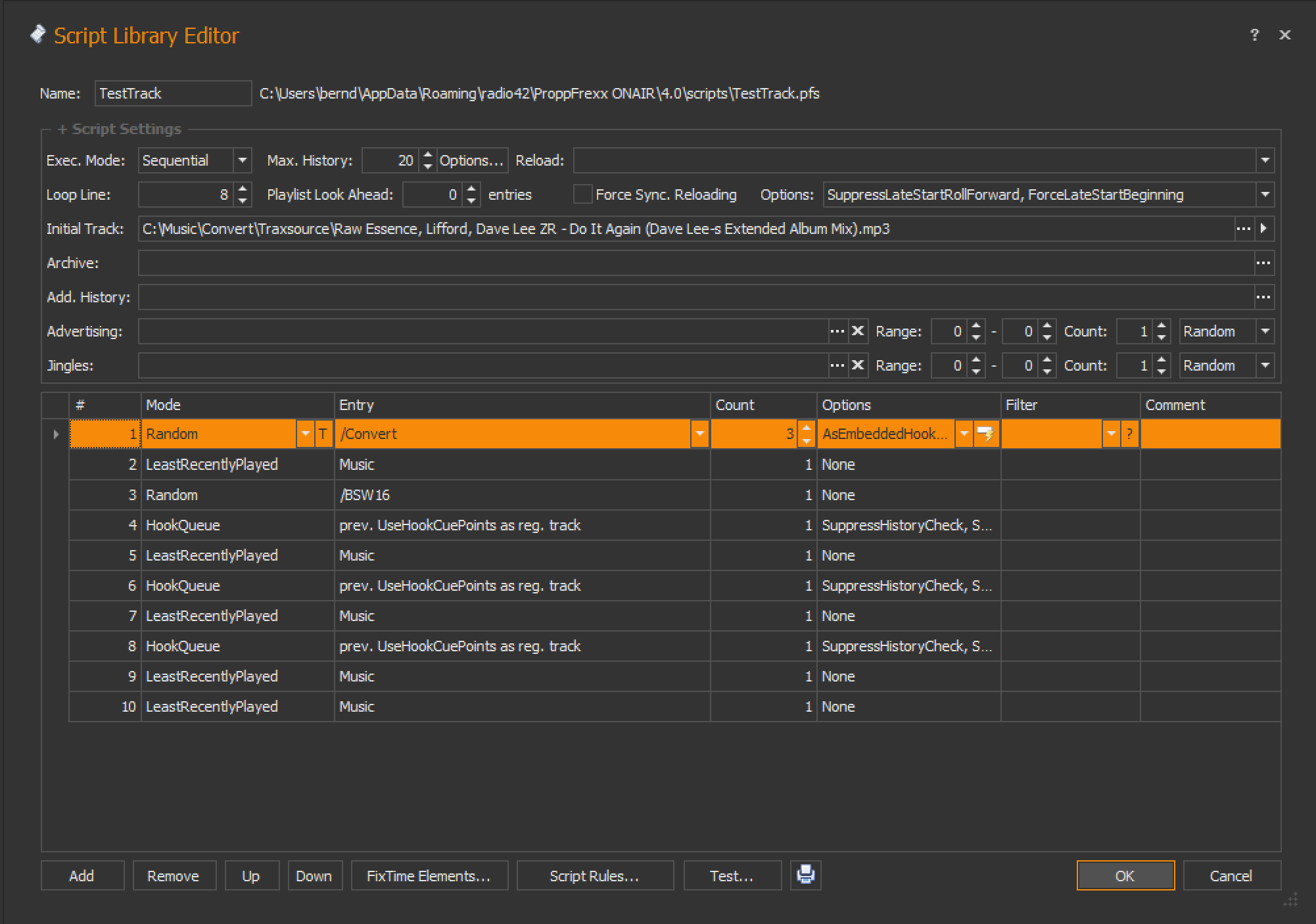

New HookQueue script-line mode:
This mode allows you to better work with and schedule hook tracks, which are short teasers for the next program.
Within a script you can first create script-lines with the 'UseHookCuePoints' or the 'AsEmbeddedHookContainer' option.
This will result in hook tracks, which are internally added to a new hook queue (organized as first-in-first-out list), as shown in the subsequent image:
Following you can now use the new script-line mode 'HookQueue'. This mode now returns a track from the above mentioned hook queue, but as a regular media entry without the hook option. I.e. this returns a track, which was previously teased as a hook entry.

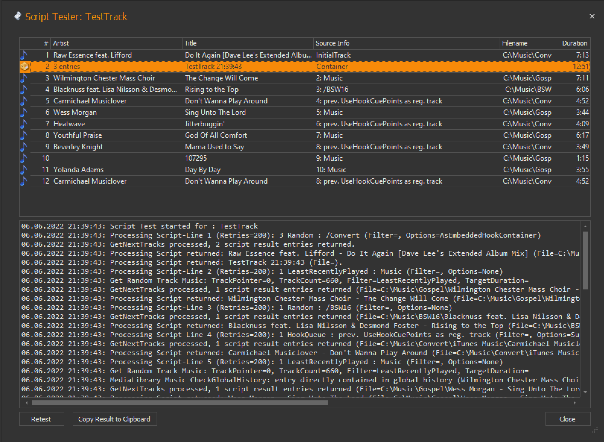

Example:
In this example first 3 tracks are placed into a hook container to tease to forthcoming entries (#2, Script-Line 1).
And finally these tracks are effectively scheduled as regular tracks (#5, #7, #9, Script-Line 4, 6, 8).
