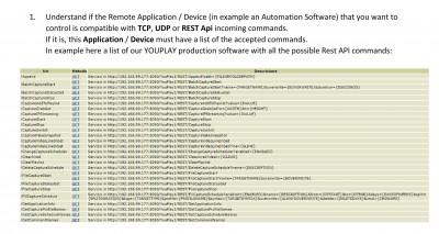

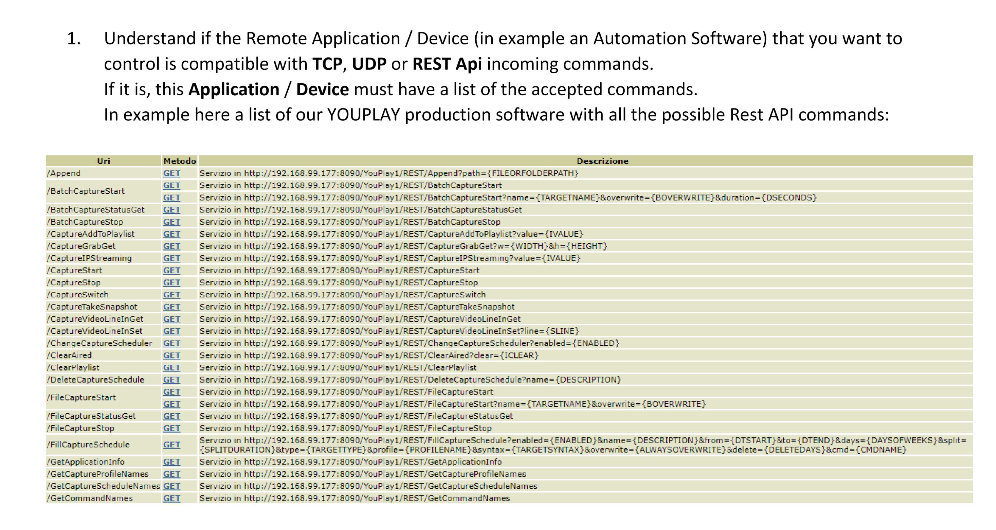

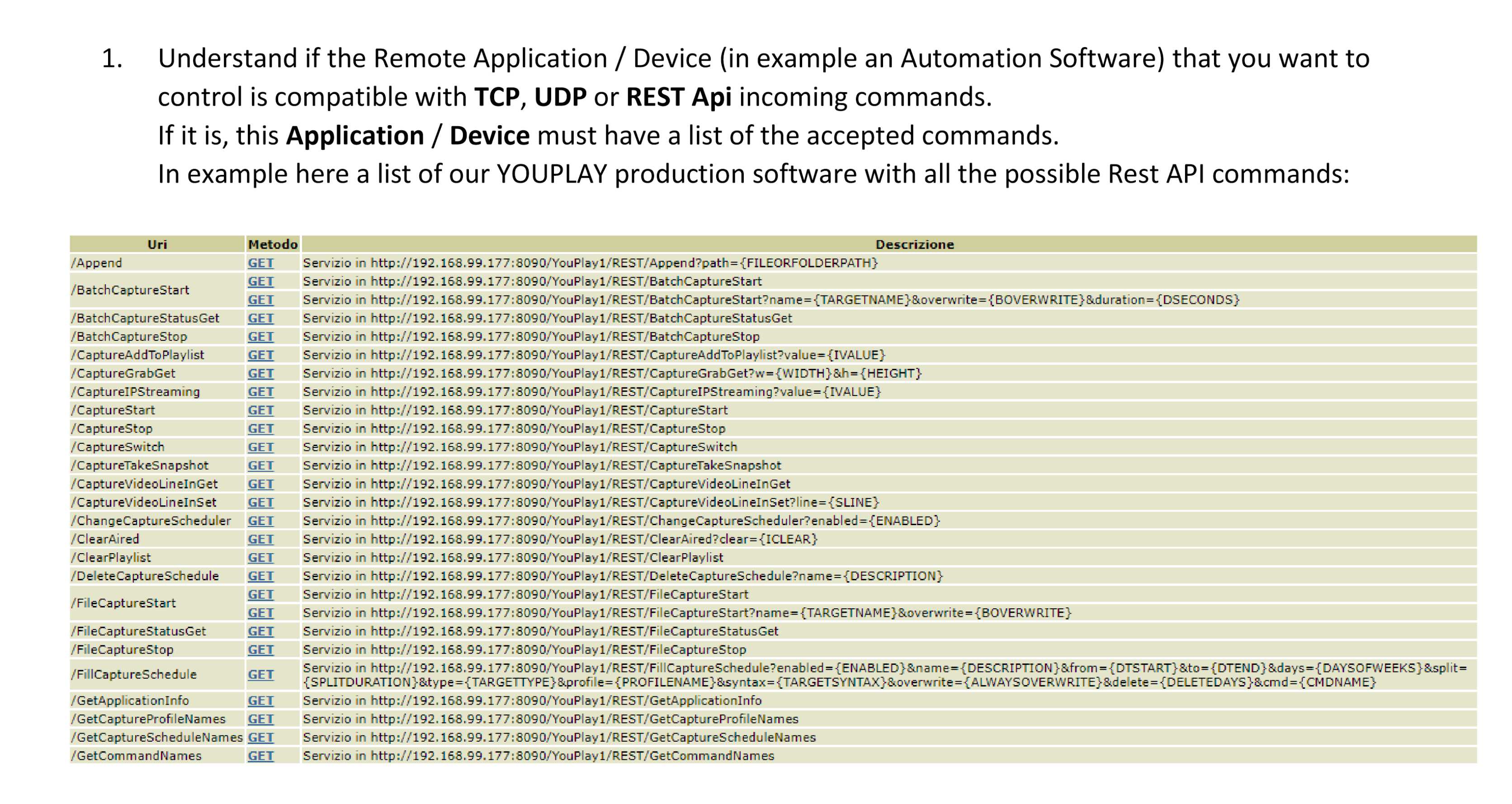

See attachment. The screenshot has been taken from that link https://www.axeltechnology.com/public/O ... TER-EN.pdf
Chapters 2.3.2 - 2.3.3
I'm considering to buy that console if PF is going to be controllable via the console.
And tell me if PF can do that.
Re: Oxygen 3000
Any REST API is unfortunately something very proprietary (from TLS, Login, the endpoint definitions, the payload etc.). ProppFrexx could theoretically implement this, but has not for the Oxygen console. As such, there is nothing out of the box. And I also couldn’t find any detailed specification from Axel Techn.
So if you have or know someone with some little coding skills, it would be most effective, if you implement this on your own and use the open command-interface of ProppFrexx. Or you ask Alex Techn., if they either can implement any digital standard?
Else, I could implement this for you, if I am provided with the full definition of what Alex Techn. has implemented.
