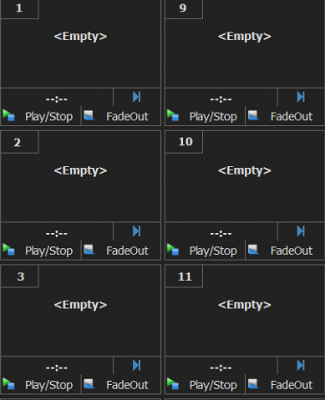

Just double checking one last thing: I understand the TOINT function. I was actually asking if it's possible to change the number on screen, so this:
Would become this:
But I guess that's not possible is it?
Re: 2 questions about cartwall
No, the numbers on screen are fixed and also used as the equivalent index number for any related cartwall commands. They can not be changed.
