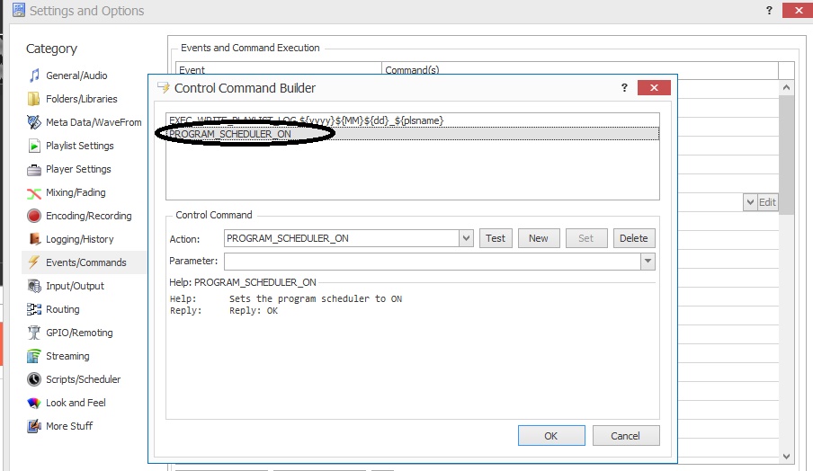

Hello,
The moment I activate a track in the player the scheduler switches on, it is also possible that this does not happen.

I am not sure what you mean by 'the scheduler switches on'.
Can you describe this in more details, what exactly switches on? Also what do you mean by activating a player?
Because by default the ProppFrexx scheduler will never start automatically. Also the AutoPlay option does not automatically start!
Maybe be you have used some control-commands to trigger that, as ProppFrexx is highly configurable, but I assume you would then know it?
Can yo maybe send a small video what you exactly mean (e.g. send a link to that video, as it can not be uploaded directly here - or use WeTransfer or alike).

I found the reason, I didn't remember making this event, so the case has been resolved. Thanks for the response anyway
