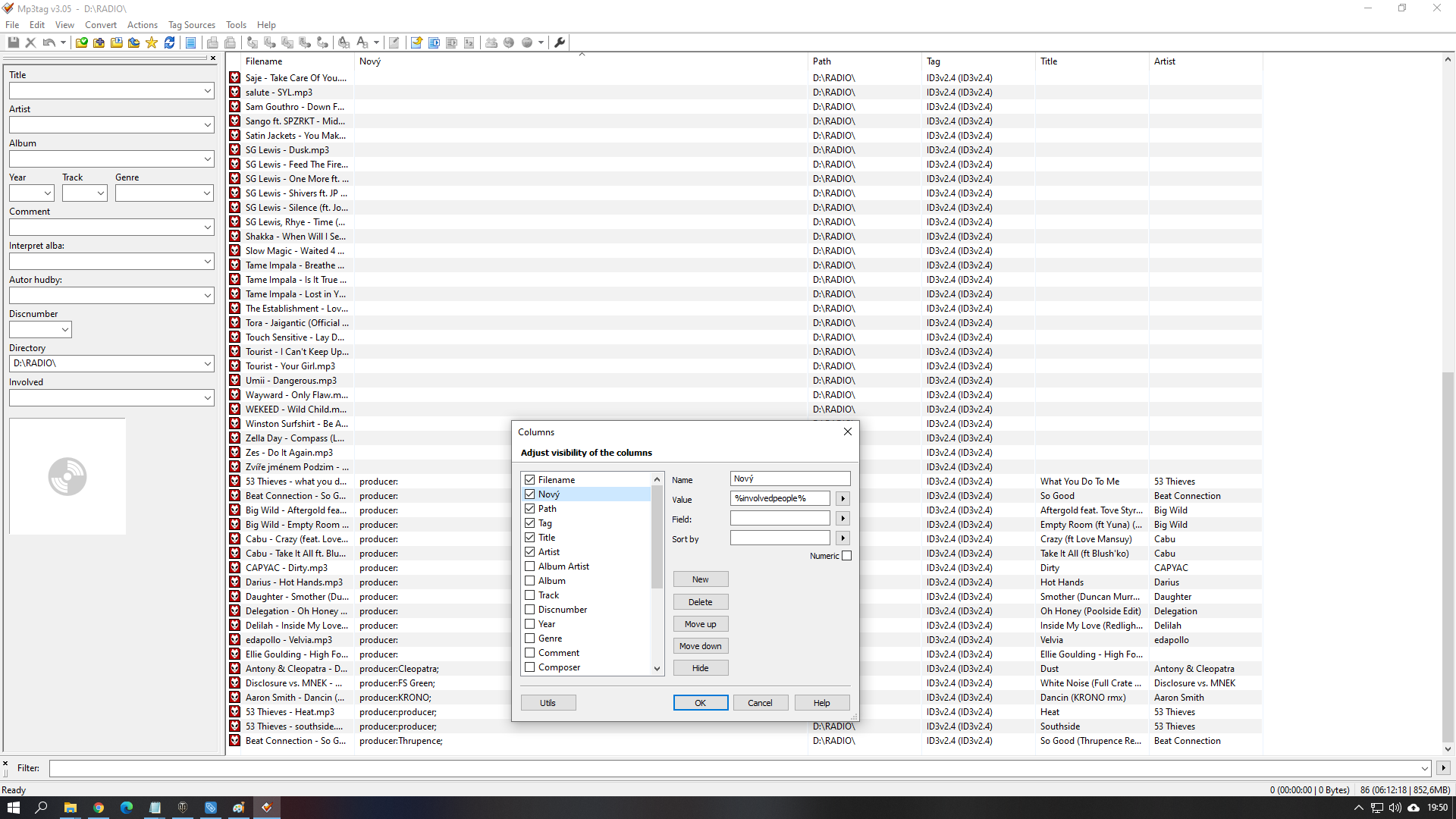

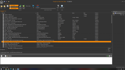

Hello, thanks for responding. produce is just a typeo. in the attached screenshot, you can see the tracks those that have "producer" in the Producer column were edited (but nothing was written in the Producer field) the last track I didn't event open in the player or editor. I just right clicked it, chose save tag and save file, then chose re-read tag and boom. "producer" popped up.
So basically, whenever I save meta tags and meta files, unless there is an entry in the Producer field, "producer" gets written in instead of staying blank.
in the second screenshot, you can see how that field looks in Mp3tag. If the tag was formatted to have that field, but with no entry, it would show "producer/:" like I saw on tracks that went through older version of Propp Tagger. Instead we have "producer:" because the slash is dropped, it shows up. Is what I think anyway. Im definitely no expert.
