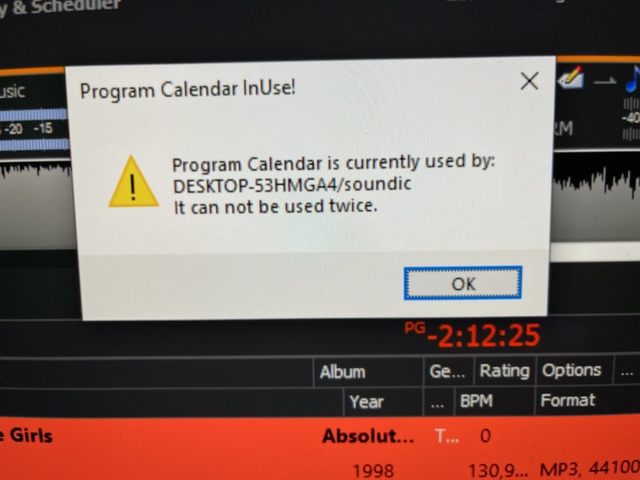

Dunno if this is a PFOA bug or if its something with my computer, but with the 4.2.3-version i am not able to edit or view the schedule.
I only get the error message as shown in picture. The schedule is running and playing as expected. I tried both to restart PFOA and to restart the whole computer with the same result. I also tried to stop the schedule and close the current playlist. Any ideas?

No, this is by design, if another user is currently editing/using the scheduler.
The lock file is created for multi-user access and might remain, if the scheduler was not closed properly.
When you click on the 'Program Scheduler' ribbon tab button, please hold down the CTRL+ALT key while doing so. This automatically removes any previous lock file.
Or...
See here: https://www.proppfrexx.radio42.com/foru ... f=7&t=2374

Thanks!
That of course solved the problem. I actually tried a search before posting, but I didnt find that thread, sorry.
