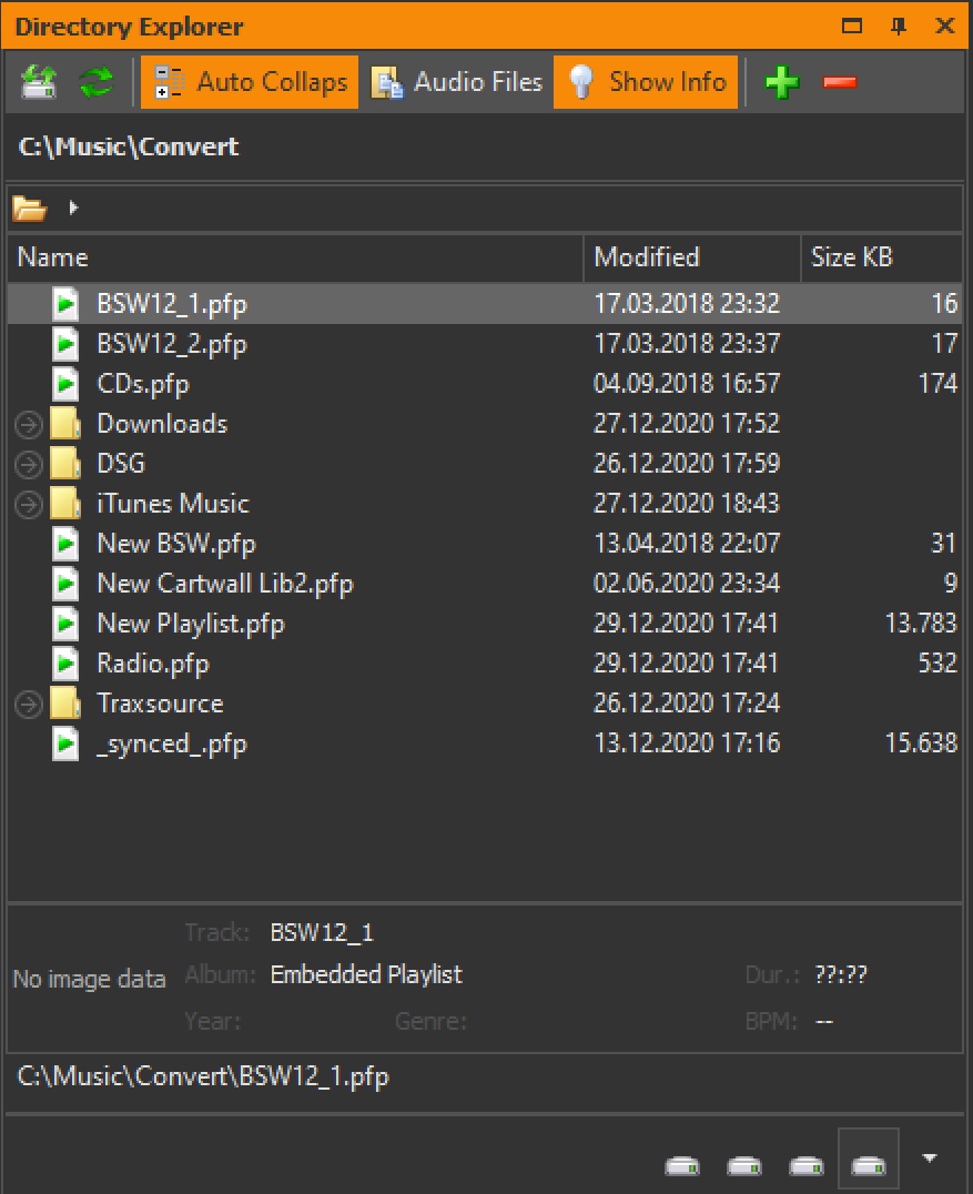

Here is what I did:
I removed all columns from one view, so that it looked like yours:
Then I closed PF and deleted the .layout file, restarted PF and it looks like this again:
