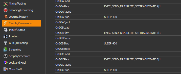

now solved by changing the parameter at OnDJAstop from 100 to 400
correction: unfortunately this was not the solution

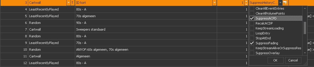

Michel, what we do with very short files is suppressACPD an SuppressFading. That works perfect. See attached.

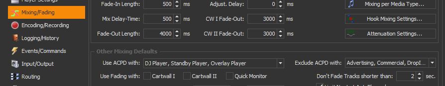

Also note, that you can even suppress the ACPD for short tracks in the general setting, section Mixing. Just define the length of tracks which should be excluded.

Thank you. Suppressing the ACPD for short tracks solved the problem.

found it here at the time:
