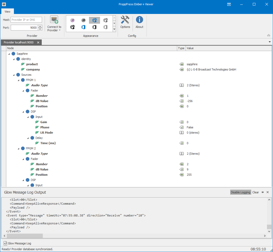

If are using professional equipment from e.g. Lawo, DHD, Axia, Orban, D&R, Studer, Jünger, Riedel, Mandozzi, L-S-B, TSL or any other company which supports the Ember+ standard - this equipment might now directly 'talk' with ProppFrexx ONAIR and ProppFrexx ONAIR might 'talk' with it as well ;-)
I am happy to announce the availability of a free Ember+ Viewer tool which you might find handy - feel free to use it, if you own any Ember+ equipment:
http://www.proppfrexx.radio42.com/downl ... mberViewer
