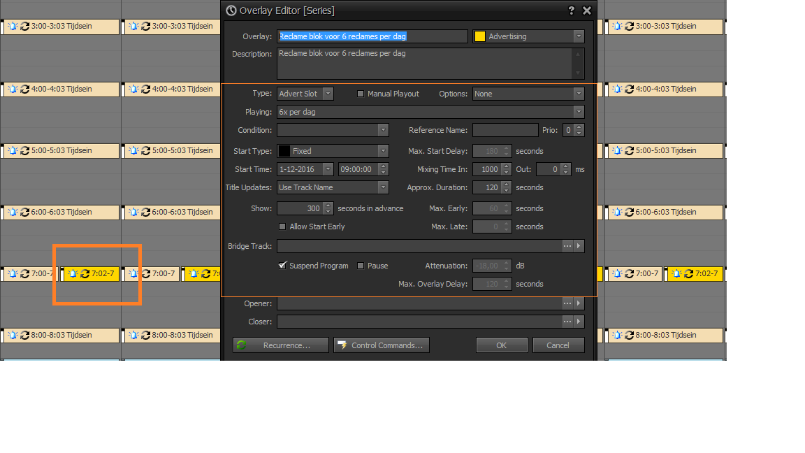

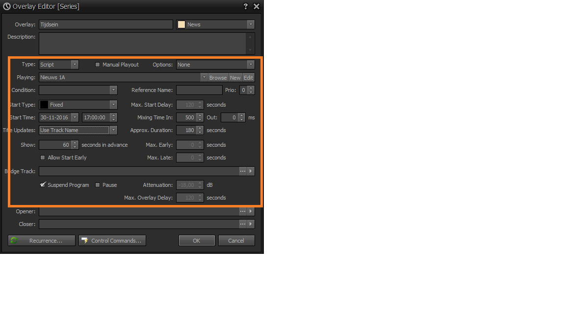

Bernd.
I did set up news and advertorials, but the commercials start before the news.
News strictly on exact hours, after that the add block.
E.g. New exactly 12:00, than the commercial break at 12:02! This doesn't work.
Are these settings oké?
What do we do the start news, and that commercials. And than the script takes over with regular music.
See screenshots.
Bumperke

First take a look at what you have configured:
- The Advert has a Start Time at the full hour
- The News also has a Start Time at the full hour
So far so good. But take note of your Show in Advance Time:
- The Adverts are shown 300 sec. in advance!
- The News only 60 sec. in advance
As such, the Adverts effectively show up 240 sec. BEFORE the News - as expected and experienced ;-)
To let the 2 start exactly one after the other in a defined order, please do the following:
1) go to the general settings, section Scripts/Scheduler and enable the 'Combine Parallel Overlays' option
2) leave the Start Times of both overlay entries as they at the full hour!
3) but change the Show in Advance Time, so they are also both EQUAL, e.g. set both to 300 sec.!
4) Set the 'Prio.' (Priority) accordingly: Prio. News to 0; but Prio. Advert to 1 ! (this defines the order when started at exactly the same time)!
That's it.
So in essence, let them start effectively (incl. the show in advance time) at exactly the same time, but use the 'Prio.' value to define its playout order.

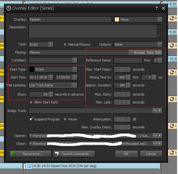

I already tried to explain: Make sure your News files are available at the time when Overlay Players shows up AND DO NOT change the file after!
I.e. download you news items earlier, e.g. at 9:55 and start your overlay only 120 sec. in advance.
And if you don't want to currently playing song to be interrupted hardly at exactly the start time, you should change your Overlay Entry's 'Start Type' from 'Fixed' to 'Soft' !
Please click on the '?' icon at the very top right of the Overlay Editor dialog to get a full description of each setting value.

Bernd, somehow it does not work.
The news starts exactly at the hour, then closer jingle overrules the news. Are settings wrong?
Overlay editor Time.png (45.42 KiB) Viewed 13403 times
When the jingle ends there is a silcence from at 3-4 seconds before the advertising starts.
This is allright? I see the mixing time. Does that has any influence, or is it related to the silence?
Will
