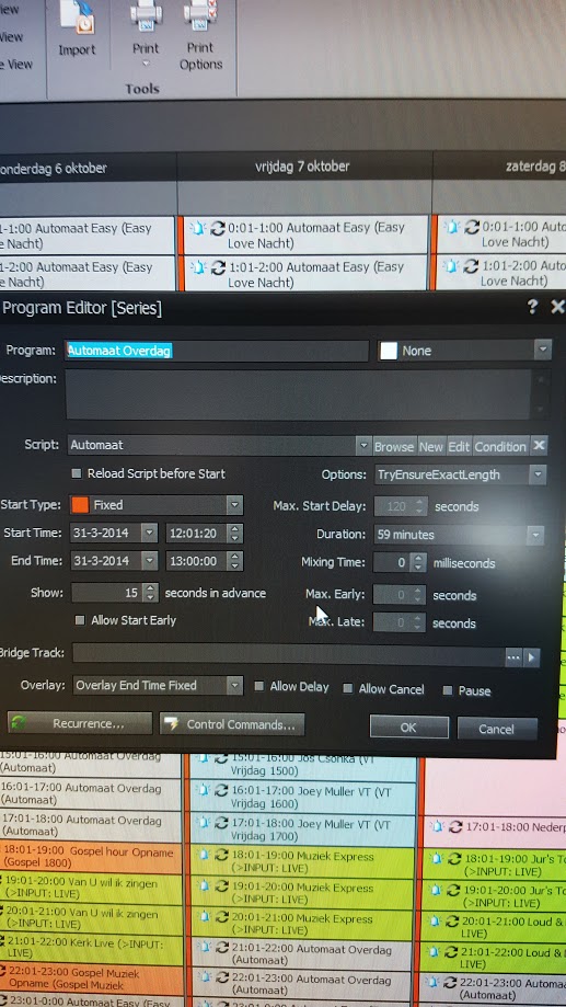

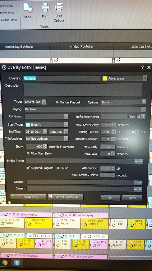

Settings overlay:
And after the overlay is done, this program is started:
What is going wrong because in PF3 it is working perfectly.

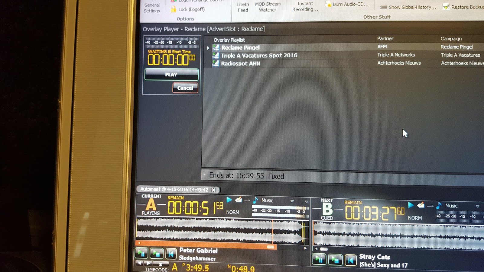

Sorry for being not clear. I mean the overlay is loading and I can start it manually but it's not started automatic like a EndsAt should.
When the timer of the overlay reaches 0 it does nothing and keeps playing the playlist unless I press play. (see screenshot)
