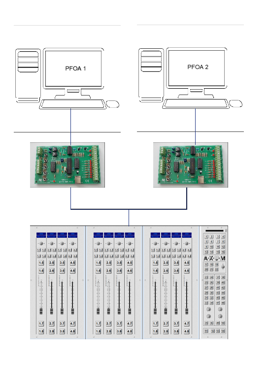

This is our studio setup:
Our axum mixer is connected thru 2 Velleman K8055 kits to both computers. The Start/Stop signals are send to both computers. If both PFOA's are running i want just one of them to react to the Start/Stop signals. The only thing that is certain on both PFOA's is that in only one of them a user will be logged in. The other pc is running the scheduled playlists unattended.
Therefore i chose the OnUserLogin/OnUserLogoff event to activate the GPIO_START_VELLEMANSERVER/GPIO_STOP_VELLEMANSERVER commands. If i activate the GPIO Velleman Server by default on startup both systems will react to the Start/Stop signals.
